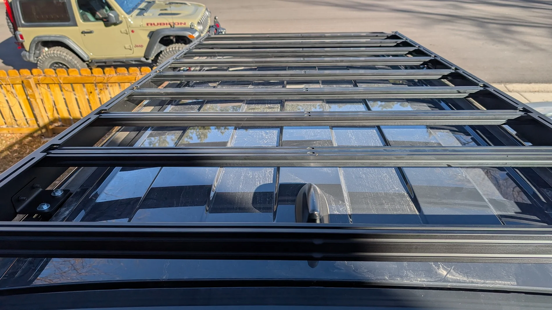

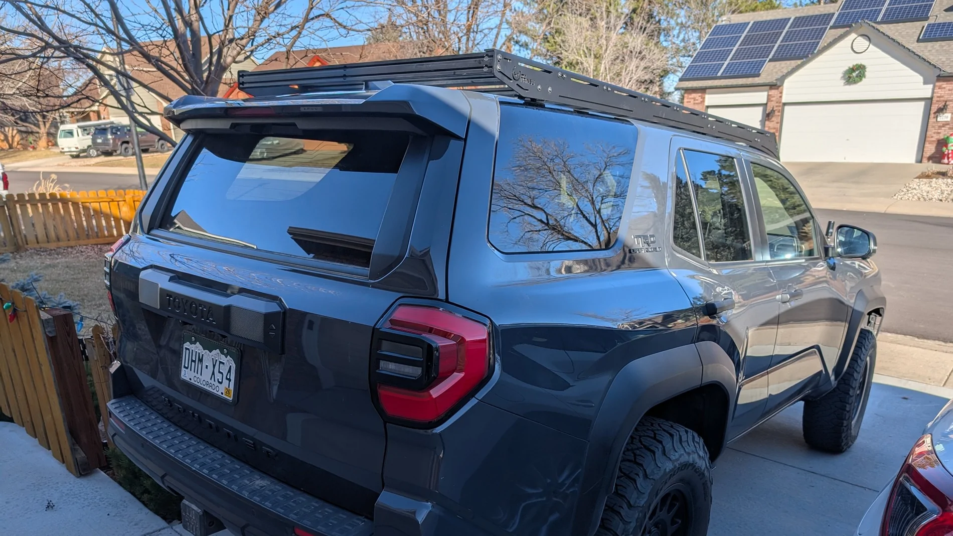

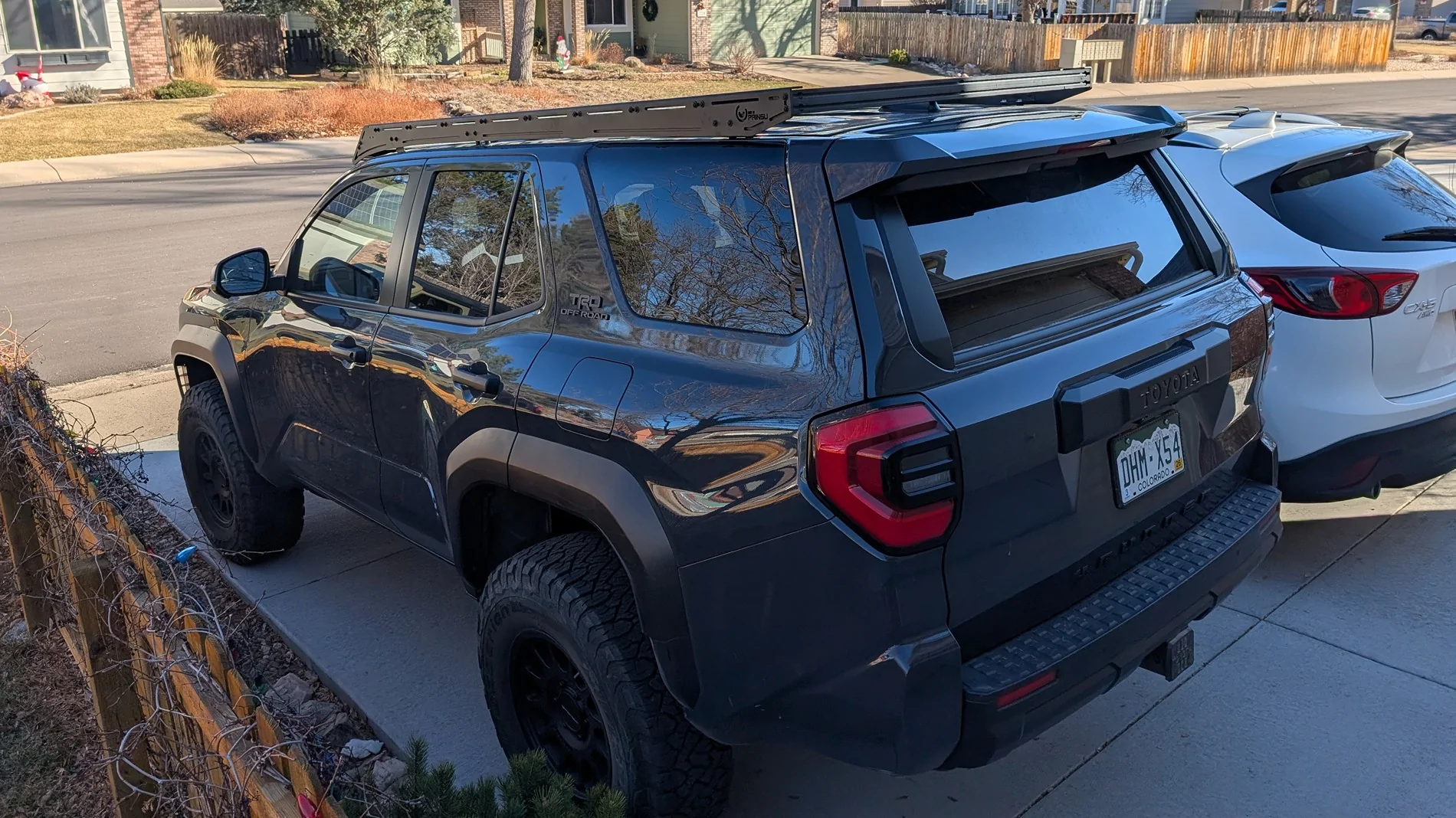

I received my Prinsu Pro roof rack yesterday (2025-12-29) and got it installed. I started while it was still light out, knowing it would be dark when I finished, but I wanted to take advantage of the relatively good weather (for this time of year in Colorado). Installation took a while (as expected), but I got it done. I decided to setup my Insta360 to record the process. It wasn’t too exciting, but I’m sharing the video anyway. The installation was pretty intuitive. I referred to the instructions (a PDF on Prinsu’s website) and a video they had posted on the installation process.
I installed this rack primarily to add roof top tent (RTT) — which I’ve had sitting in my garage for a while now. The next step is to get the RTT installed “soon”. Some pics from this morning (now that it's light out)...

I know some people had problems getting the rack squared and the install was not correct where the rack actually scratched the roof paint.
After you got it on the roof, did you have to
Make any adjustments to make it fit exactly how you wanted it?
I made a mistake using a socket extension that was too wide and pushed the bracket to one side while tightening, making the rack mount a little off center. I just had to loosen everything up, recenter, and tighten back down with a normal "short" socket and socket wrench. In retrospect, this was pretty obvious, but I was doing this at night. I also left the brackets on the rack a little loose and tightened them all the way after the brackets were tightened to the vehicle. In any case, I'll check centering and retighten everything after I've driven it a bit.
Also did you leave a gap for the front end wind fairing?
The seal that's pressed onto the wind fairing rests against the body. I know some people are concerned about this leaving a mark, but it's not something I'm too concerned with. If I was really concerned, I think there are adhesive products that can be applied to the body first. I'm also not sure how much wiggle room there is with this rack if you're trying to leave a gap.
The main thing I'm concerned about right now is how much noise this will make a freeway speed (related to the wind fairing, etc.). I'm still not sure if I'm going to leave my rooftop tent on most of the time, or attempt to store it most of the time (this might effect, noise, etc. too). I don't have a lot of storage space.
What do you think were the major challenges on installing this roof rack.
It was pretty straightforward, just time-consuming, and a little cumbersome moving it and positioning it. There's always the question in the back of my mind about whether I've done something wrong that will require disassembly and wasting a lot of time. The instructions were OK. There were a few places where some clarification would have been nice.
I think it was right around the freezing point, maybe a little warmer when I was doing this. So, the wind fairing seal was really stiff. I'm guessing it would have gone on easier if it was warm out. I had one bolt that was defective (couldn't fit the allen wrench into it because it was warped, but they sent enough extra bolts that I was fine).
I thought lifting it onto the vehicle was going to require some extra hands or be really difficult by myself. But that wasn't too bad either. I'd still recommend having someone help unless you're used to moving things like this by yourself, getting creative, and being cautious not to get injured or damage anything. You see in the video where I used some thick/soft packing material the protect the vehicle. Moving blankets would probably work better. I thought all of my moving blankets were in storage, but then I found one after I already got the rack in place.
I was worried that lining up the rack on the mounting hardware was going to be really difficult -- especially needing to support the weight at each corner before attaching. It's probably hard to see in the video, but I just propped up each corner (rolling up some of that foam padding I used earlier). This allowed me to seal and prepare the hardware before removing the foam roll and setting down each corner. I left each corner loose as I did this to maintain some wiggle room until I was ready to tighten everything down. Of course, I had to loosen, adjust, and retighten some brackets as mentioned earlier.
I watched the Sherpa Capital install video and they assembled the rack piece by piece on the roof and did not assemble on the ground. Not sure what is the better approach..
I didn't see that video, but that might have been a better approach to avoid having to lift the entire rack up in one piece. I didn't think of trying that but I would have certainly considered it if the thought crossed my mind (or if I tripped across the video you mentioned beforehand).
One thing I did a little different was assemble it upside down on the ground so it would set flat and I wouldn't have to hold up each crossbar end when I tightened them. It might be obvious to some, but when you're trying to line up hardware like this, it helps to look right into the frame hole and line up the bar by eye rather than try to move around the crossbar and just try to "feel" for where the bolt is supposed to go. You can also use a small screwdriver to help line up the first hole, but I think just getting down and looking at it works best. This might be easier to see assembling piece by piece on top of the vehicle, but you'll probably need some way (or a helper) to hold up the other side as you get each crossbar in place. In any case, you would want to install all the bolts loose first. Tightening down on one side while letting the other side "hang" would create stress on the bolts and rack.

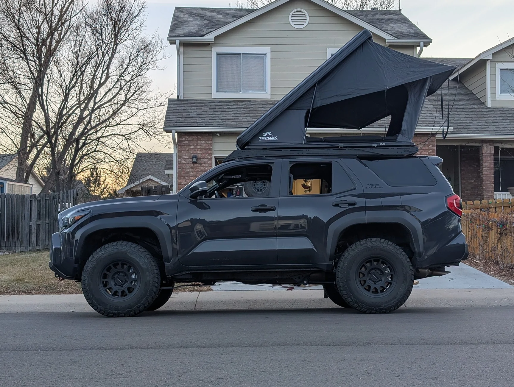

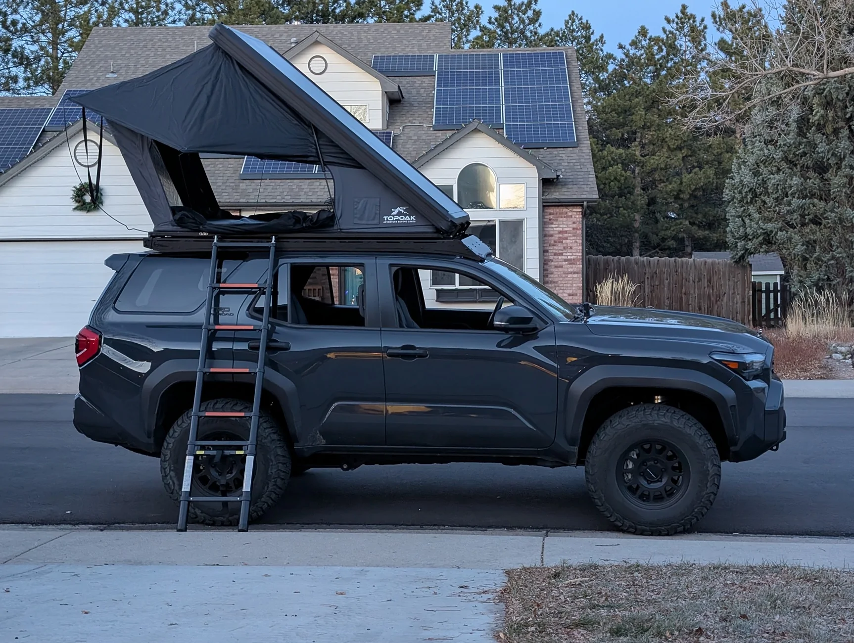

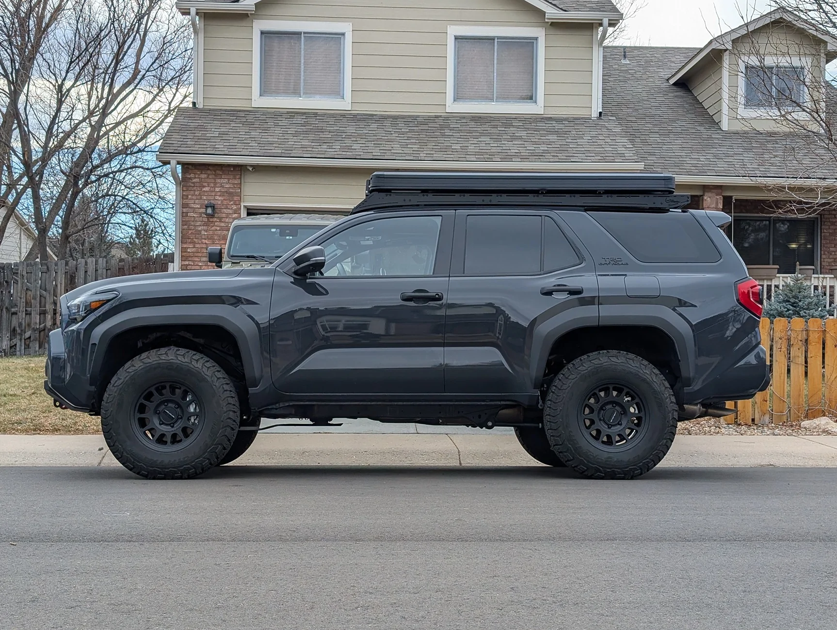

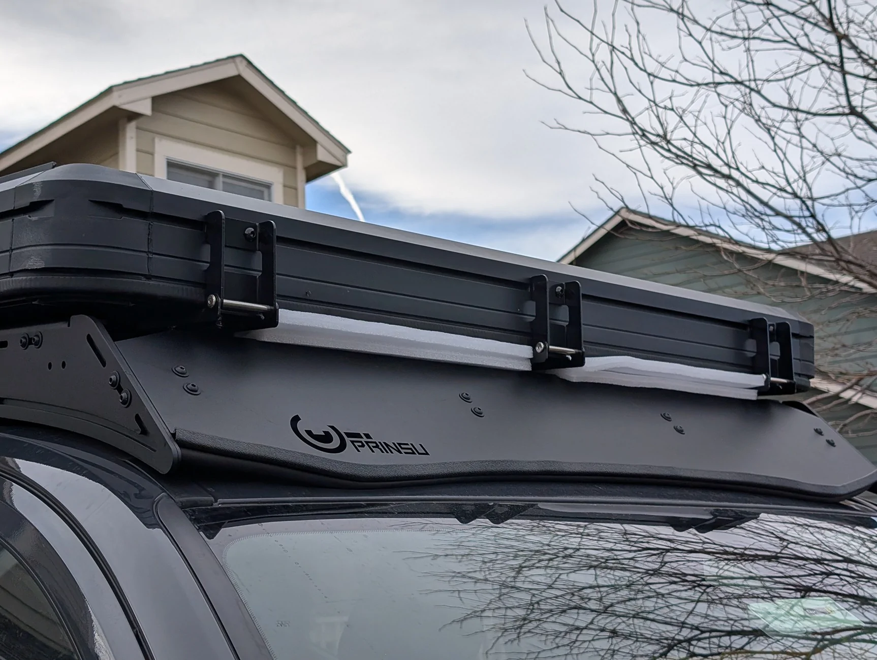

The RTT caused a whistling noise, so I mounted it more forward which got rid of most of the noise...
2025 2026 4runner 6th gen Prinsu Pro roof rack installed - video PXL_20260104_203959178
To get rid of the rest of the noise, I figured out the gap between the front of the rack and RTT needs to be blocked. I temporarily blocked the gap with some packing foam, but I need to find a more permanent solution:
2025 2026 4runner 6th gen Prinsu Pro roof rack installed - video PXL_20260104_210755562
I'll be on the lookout for some foam and/or rubber solution (black to match color of rack/RTT) that I can semi-permanently attach -- likely using a combination of pressure and adhesive. I got it up to 65+ MPH like this and it was relatively quiet.
With the RTT mounted farther back as I originally had it, the noise was pretty bad -- definitely something that would be persistently aggravating on a long road trip. Mounted farther forward, the noise was reduced significantly, but there was still a noticeable high-pitched whistle -- just much quieter. After placing the foam as show in my last pic, the high pitch sound was eliminated. So, at least I know what I need to do -- block that particular gap.
