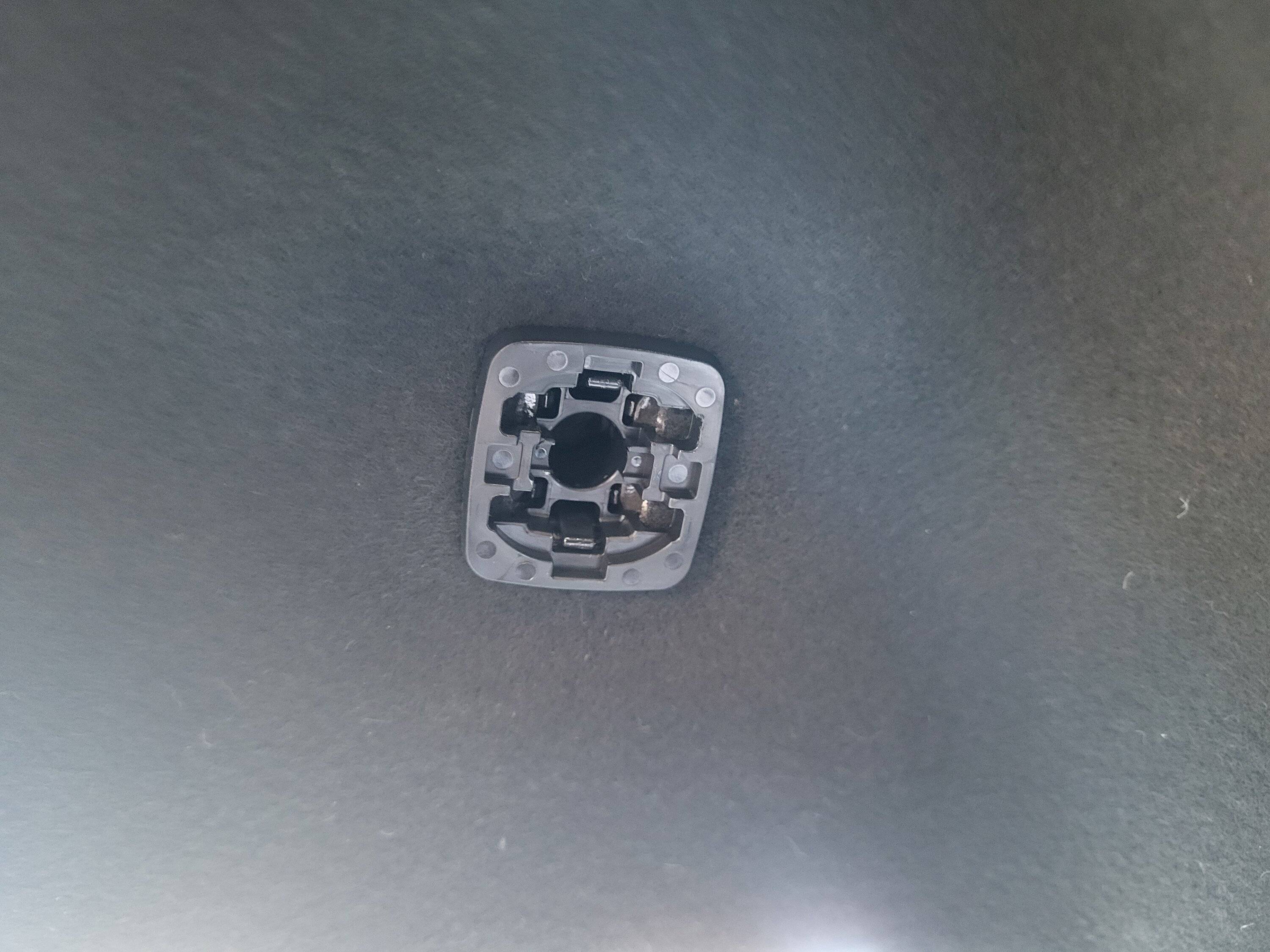

In step 5, the instructions will then have you remove the visor mount clips and base (that secure your sun visors). This will allow you to pull down the liner for routing cables through it. The first part just requires your fingers turning the clip counterclockwise, then pulling down. Removing the base is a little trickier since you need to be pulling down on the base while releasing two very small clips. I found that using a very small flathead screwdriver was needed for releasing the clip mounting plate. While gripping the base with needle nose pliers and pulling down, I used the small flathead screwdriver to release one clip at a time by pushing it into each clip.

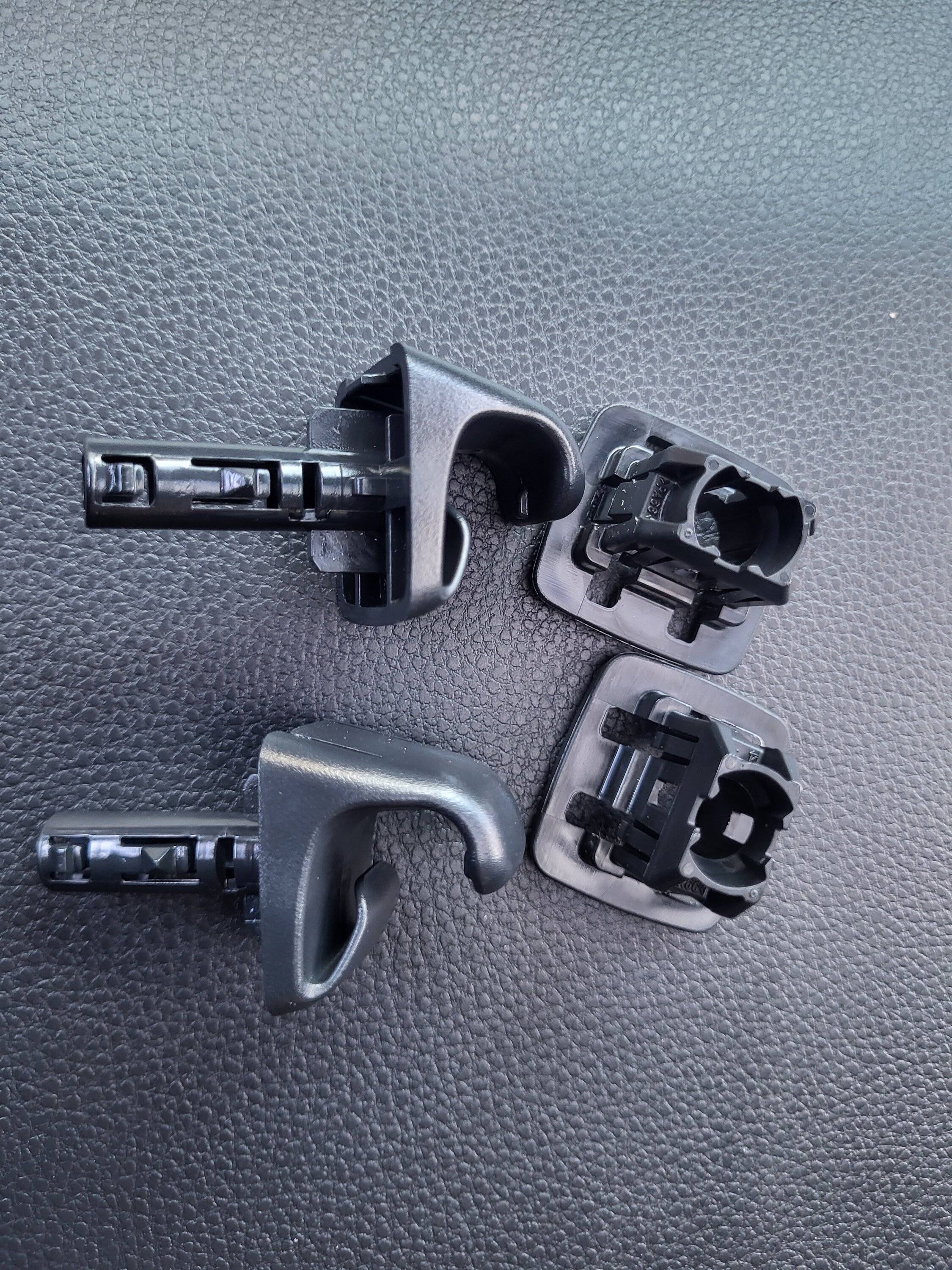

Here's what the parts look like that were removed in this step:
2025 Toyota 4runner OEM Toyota Integrated Dashcam DIY install instructions write-up with photos 20250228_134226

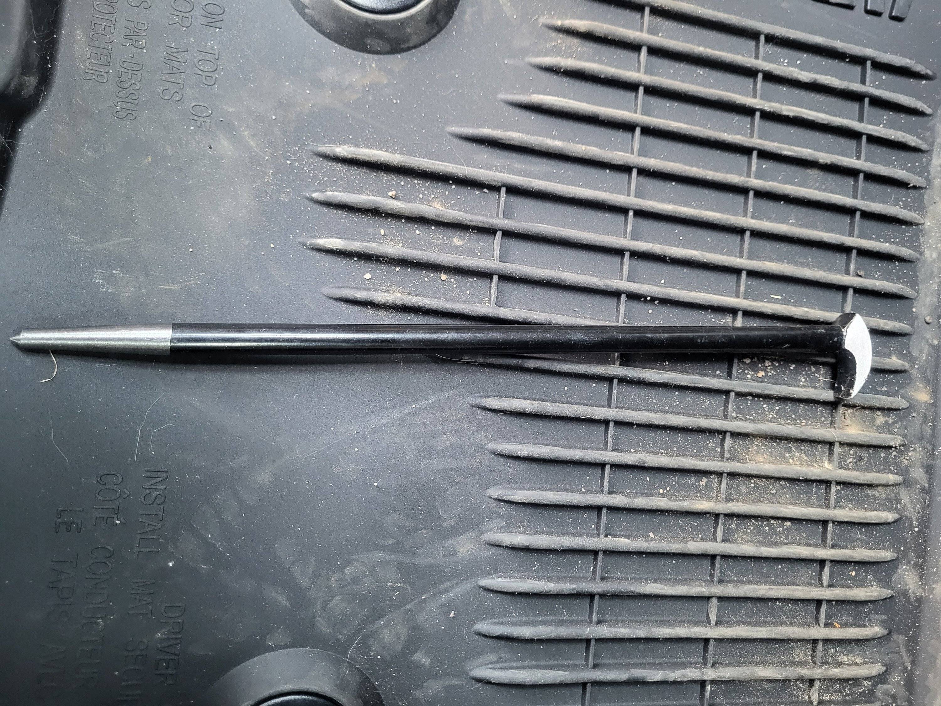

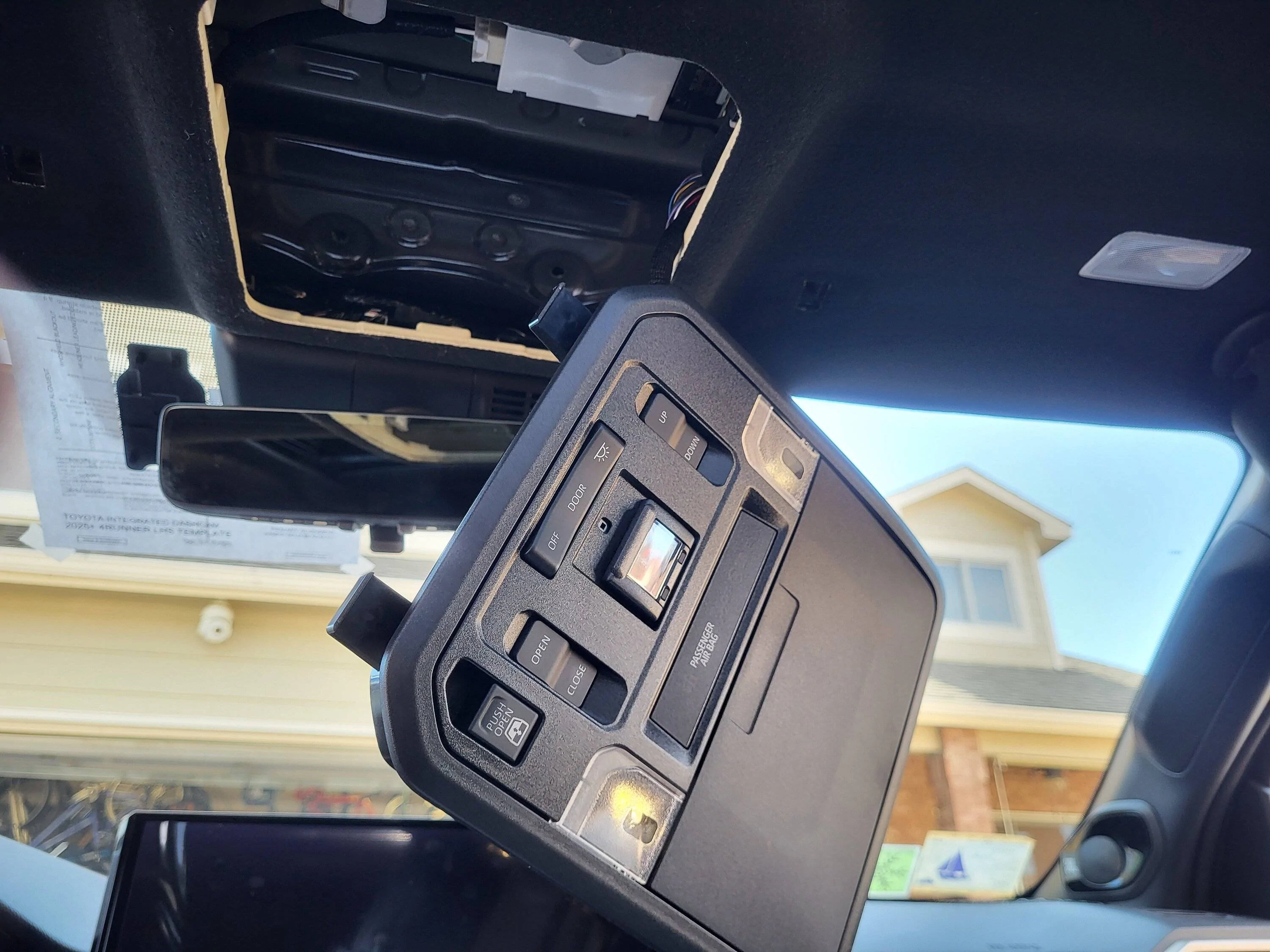

Step 6, removing the map light console, took me the most amount of time. I was uncomfortable at first applying a lot of force, not knowing how this would really "pop out". There are some plastic clips that take a considerable amount of force. I eventually found out that using a small pry bar worked well for this. This is the tool that I used:
2025 Toyota 4runner OEM Toyota Integrated Dashcam DIY install instructions write-up with photos 20250228_135613
Here's what the roof map light console looks like dangling from its electronic interface:
2025 Toyota 4runner OEM Toyota Integrated Dashcam DIY install instructions write-up with photos 20250228_135600
I just left the wire harness connected, despite the instructions. I think this is a precautionary step so it doesn't disconnect on its own, fall, and break.

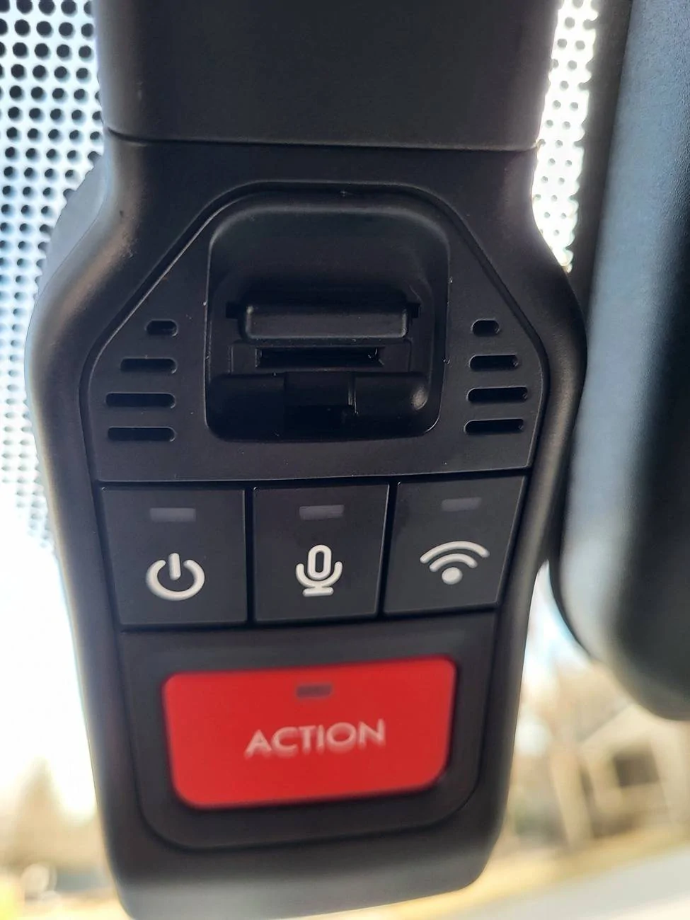

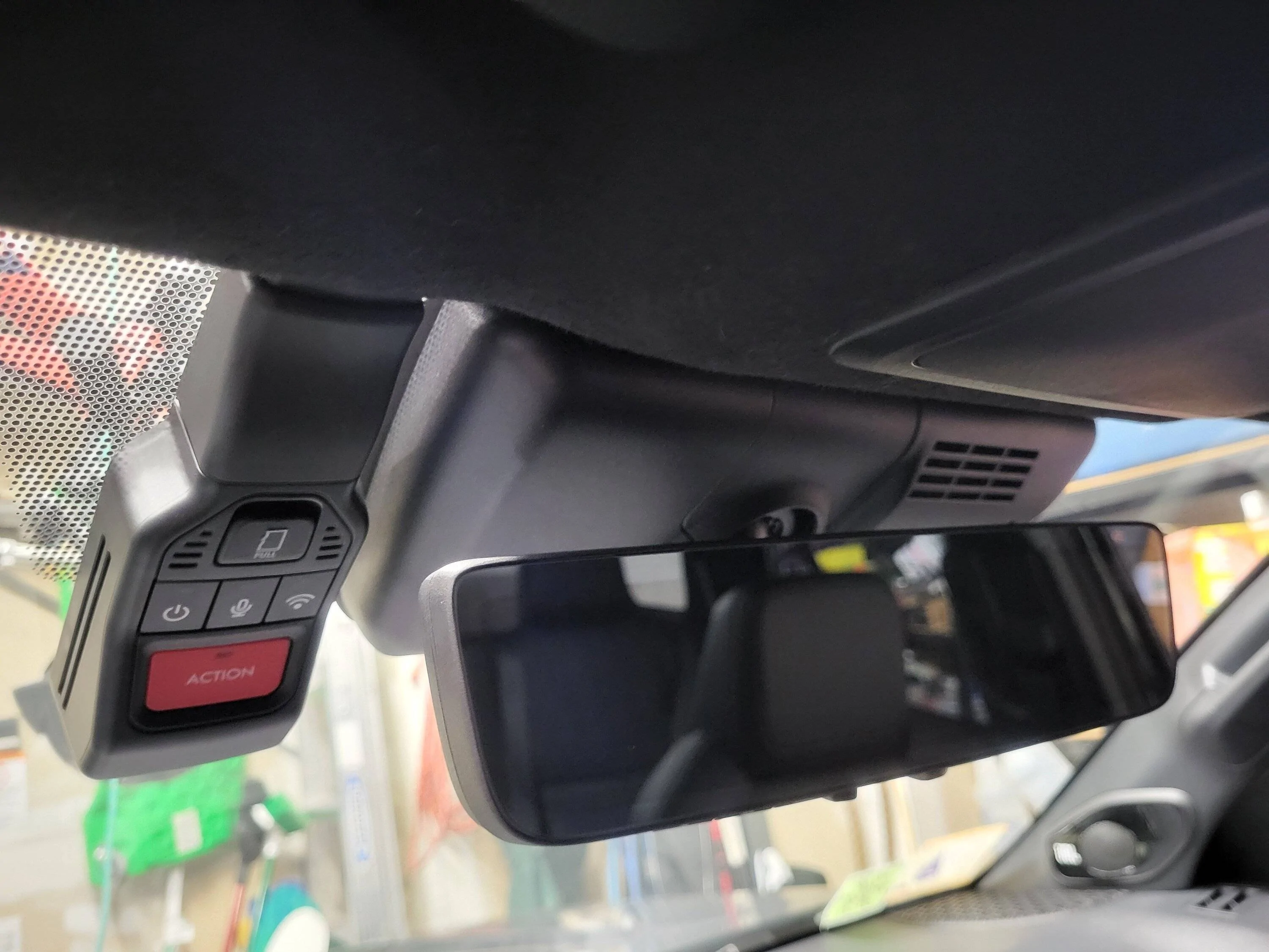

The rest of the physical installation was pretty straightforward from the instructions. Here's what it looks like installed:
2025 Toyota 4runner OEM Toyota Integrated Dashcam DIY install instructions write-up with photos 20250228_164254
2025 Toyota 4runner OEM Toyota Integrated Dashcam DIY install instructions write-up with photos 20250228_164329

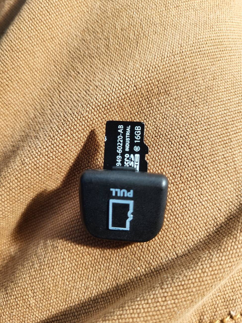

I just upgraded the SD card from 16GB to 128GB. Turn off the cam before starting. You have to pull the SD card cover down then pull it out. The cover is attached to the SD card, so the SD card is removed when you pull out on the cover. You then slide the SD card to one side to remove it from the cover, and slide in the new SD card (reverse process to install new SD card back into dash cam). Turn the vehicle on and then start the dashcam. Push the wifi button, connect with the Toyota Dashcam app on your phone, then go to settings and format the new SD card. That's what I did anyway and it seems to be working fine.
2025 Toyota 4runner OEM Toyota Integrated Dashcam DIY install instructions write-up with photos 20250305_145903
2025 Toyota 4runner OEM Toyota Integrated Dashcam DIY install instructions write-up with photos 20250305_150624
2025 Toyota 4runner OEM Toyota Integrated Dashcam DIY install instructions write-up with photos 20250305_150555

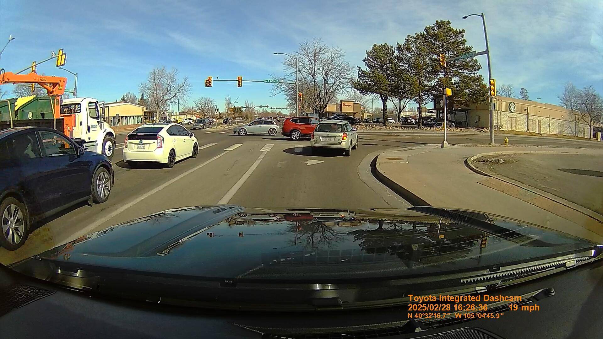

The OEM integrated dashcam quality seems pretty good in video footage. This video recording was posted by @jerrycaparros in his delivery thread.
Came across more video footage of the Toyota Integrated Dashcam from a 2025 4Runner

Do you feel like it hampers your line of sight? When I look at stoplights, etc, it blocks things.
Starting to think about removing it
