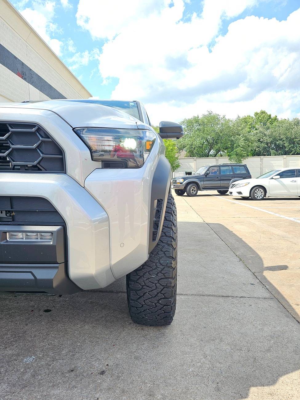

I recently got my ORP and installed a Peak collar lift. It gave 2.25" in the front and I chose the 2" collar in the rear. I put some 17x8.5 +18mm offset KMC 722 wheels on it with 285/75/17 BFG KO3 tires on it.
Originally I had Method 706 wheels that were discontinued and heavily discounted from Discount Tire. Turns out I got the super rare version that was made for Land Cruisers and has no center caps. They looked silly and Method Wheels didn't disclose it. It took several emails back and fourth with them for them to even realize I had this particular product code with no center caps.
So far so good. Haven't off roaded yet but will soon.

You need to do any trimming on the front bumper? Or have any rubbing at all?

On the failed rims that were +35 i came really close to rubbing but was fine. These current +18 rub backing out of my driveway. So any flexion in the front suspension gets them to touch slightly. I will have to tuck the liner a bit. If you have any videos on how to do so please send me them lol

I’m running same size tire and got some rubbing on the mud guards and the front a little bit. Need to look up the offset on the rims. Got some different mud guards on the way that sit flush since stock ones seem to protrude into the wheel well a little bit.
Unfortunately haven’t found any videos on the front liner yet.

I deleted those front mud guards and brackets asap as I knew it was a potential point of contact. I was originally planning on 35s but went a little more conservative.

Is there a bracket behind the liner that comes out once the front mud guard is off?

Behind the liner no. But the mud flap comes off and there's some metal pieces you can remove. I'm trying to find the video I saw that showed it. Also I was able to undo my front fender liner and just push it further into the bumper and it's holding and no more rubbing. One day someone will come up with a badass product with sturdier liners im sure. Till then this works. I took her out to get a little dirty today. Something I noticed was when mud gets on any of the cameras you can't use the off-road camera setup. It'll show you the rear camera but that's it. It greys out the option for the off road camera view with the sides and front. So heads up for any mud lovers.

You re secure the front liner in some way after pushing it up?

I didnt! I'm gunna try to soon but I just temporarily created space. I rescrewed the piece I took out and tucked the liner behind it so its held back a bit but not super secure.
