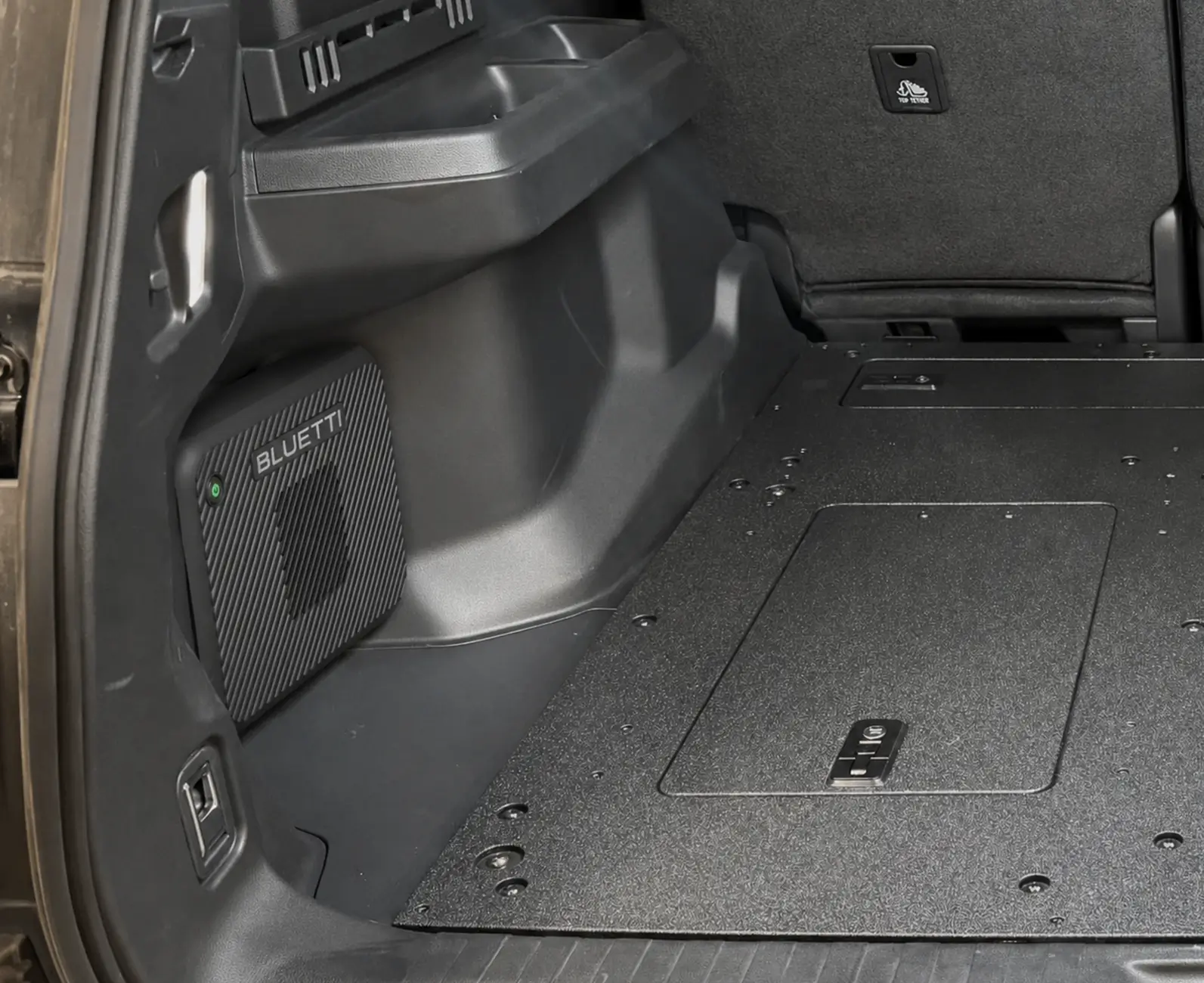

Hi guys, I just got the Bluetti Car Charger 2, and I’m trying to decide where to put it so it doesn’t get dinged or hit by suitcases, beach chairs, and other things.

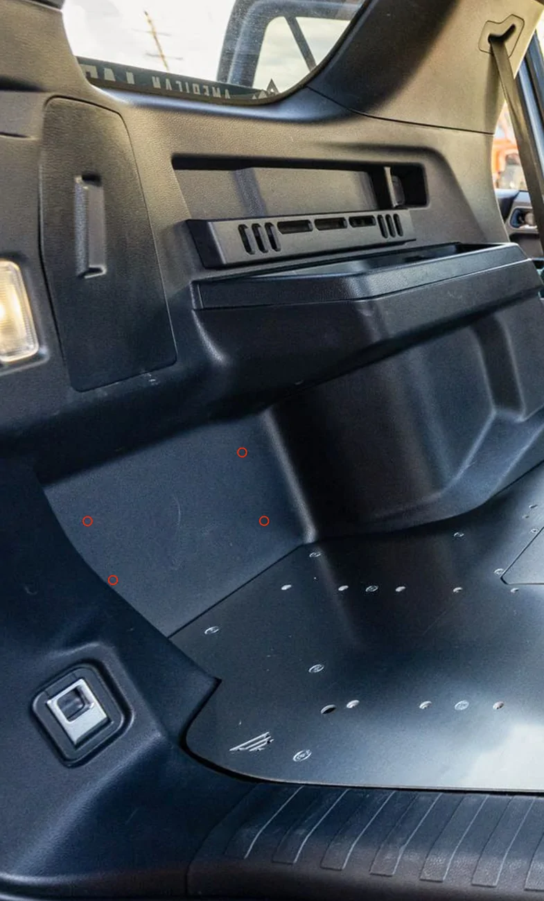

This spot looks good, although charger might be a bit smaller than in the picture. The wiring comes from the bottom. I could turn it upside down, but it would look a bit messy, even though it would be easier to use. I’m thinking of wiring it through this console for the third row seats. I’ve seen some recent posts that say there’s a lot of space there, easy accessible when you take of upper shelf trim. Maybe I could find some nice flush mounts for the MC4 and XT60 connectors, since those are the only ones I’d be plugging in and out, but I am ok even using some rubber grommet
2025 2026 4runner 6th gen Installing Bluetti Car Charger 2 1781305848608-g

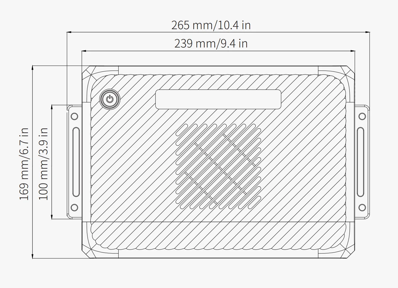

I think I will have trouble mounting charger onto the tiny plastic trim. It doesn’t seem very secure at all. Charger has mounting points on both sides, but I’m not sure what’s on the other side, and I’d prefer not to use self-tapping screws. Does anyone know any mounting plates that I could fasten with 3M tape to the plastic trim and then screw charger plate? Charger needs to be removed to connect or disconnect wires.
2025 2026 4runner 6th gen Installing Bluetti Car Charger 2 1781306646817-9
Anyone tried anything similar?

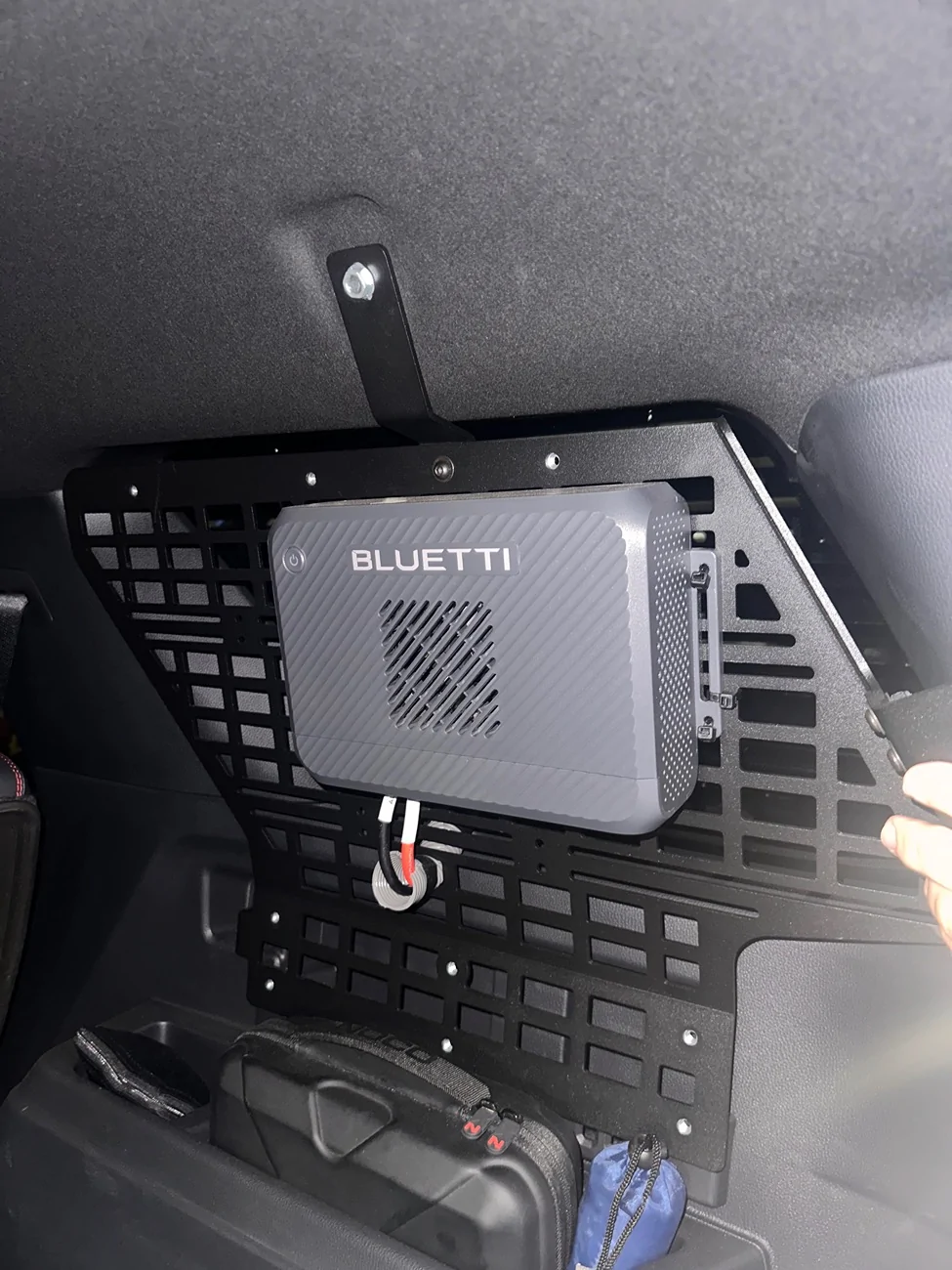

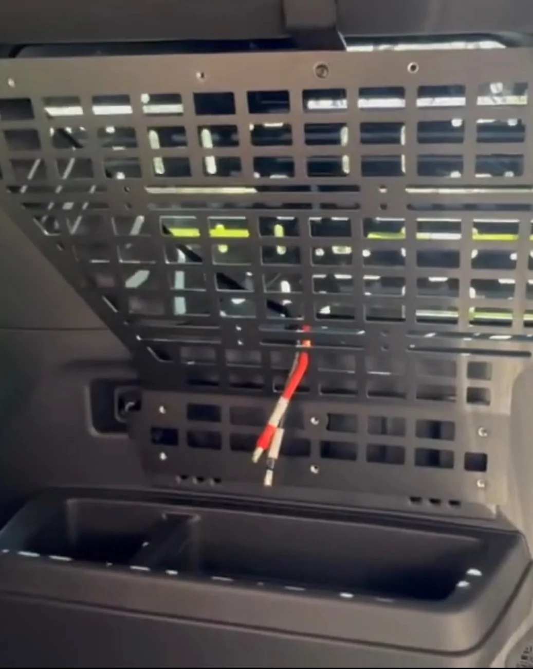

I would make sure you have room on the bottom for the cables to come out. Take a look at them and make sure you have room to bend them. Also, make sure you leave room for it to vent and breathe. Here’s where I put mine. Passenger side rear interior Molle panel.
This is a great overlanding setup! I was considering vent orientation, which is why I like the sunken area on the left, as It will still give room if I put a large suitcase next to the wheel arch. Do you think it needs some space on the back part (where there’s no vent)?
I might add some spacers. And one last question: if there’s no load, will this not work at all? I’d just occasionally put a Bluetti Elite 200 to charge, but it won’t be permanently installed.

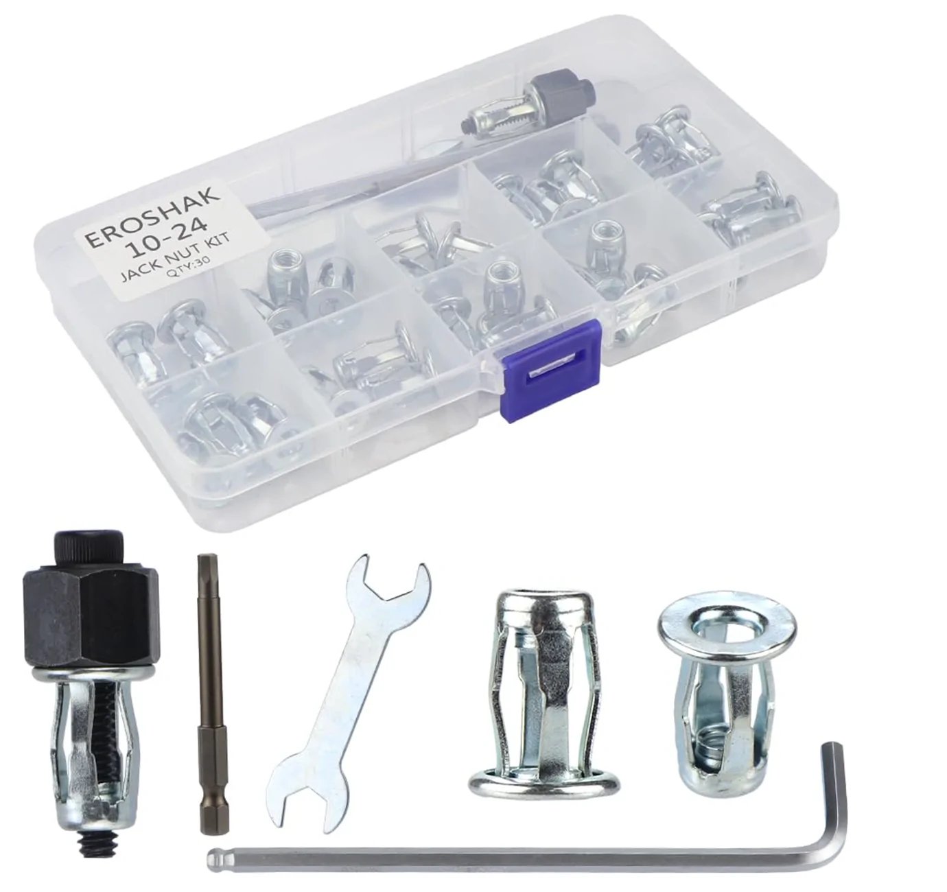

I know its not that relevant to this thread, but I just ordered this jack nuts/rivnuts - never used it, but goal is to use 4 of these
2025 2026 4runner 6th gen Installing Bluetti Car Charger 2 1781544753577-rq
To mount 4 anchor points for bluetti charger here:
2025 2026 4runner 6th gen Installing Bluetti Car Charger 2 1781550293999-om
Is this plastic trim firm enough? I did some research and this are lightest jack nuts out there…

Just realized you have a non-hybrid model. I have a hybrid and so had to work around that.
