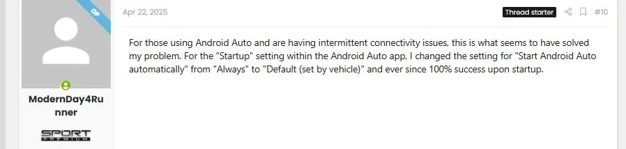

For those using Android Auto and are having intermittent connectivity issues, this is what seems to have solved my problem. For the "Startup" setting within the Android Auto app, I changed the setting for "Start Android Auto automatically" from "Always" to "Default (set by vehicle)" and ever since 100% success upon startup.
