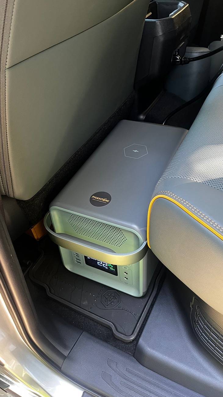

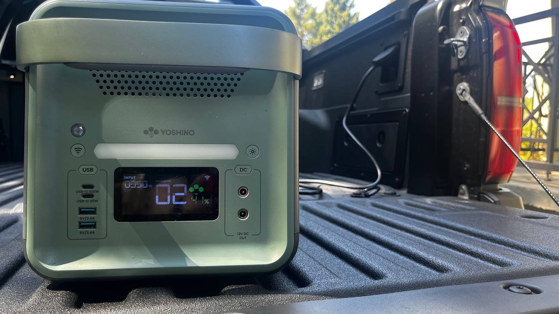

Test 1: 360W Continuous Load
• I set my power station to pull exactly 360W continuously from the truck’s inverter.
• With the truck off and the inverter running, I got the following engine cycles:
• Engine stayed off for 10 minutes while drawing 360W.
• Engine powdered on for 7 minutes to recharge the hybrid battery + supply 360w (continuous).
• After the engine shut off again, it stayed off for another 17 minutes, then ran for 6 minutes and 15 seconds before turning off again. (The longer engine off time can be attributed to the fact I made efforts to turn off all electrical systems on the truck during that cycle, including the infotainment screen, all dome lights, A/C, etc. the only thing I couldn’t turn off was the instrument cluster, which was dimmed to the lowest setting. So every watt counts if you’re looking to keep the engine from cycling frequently).
