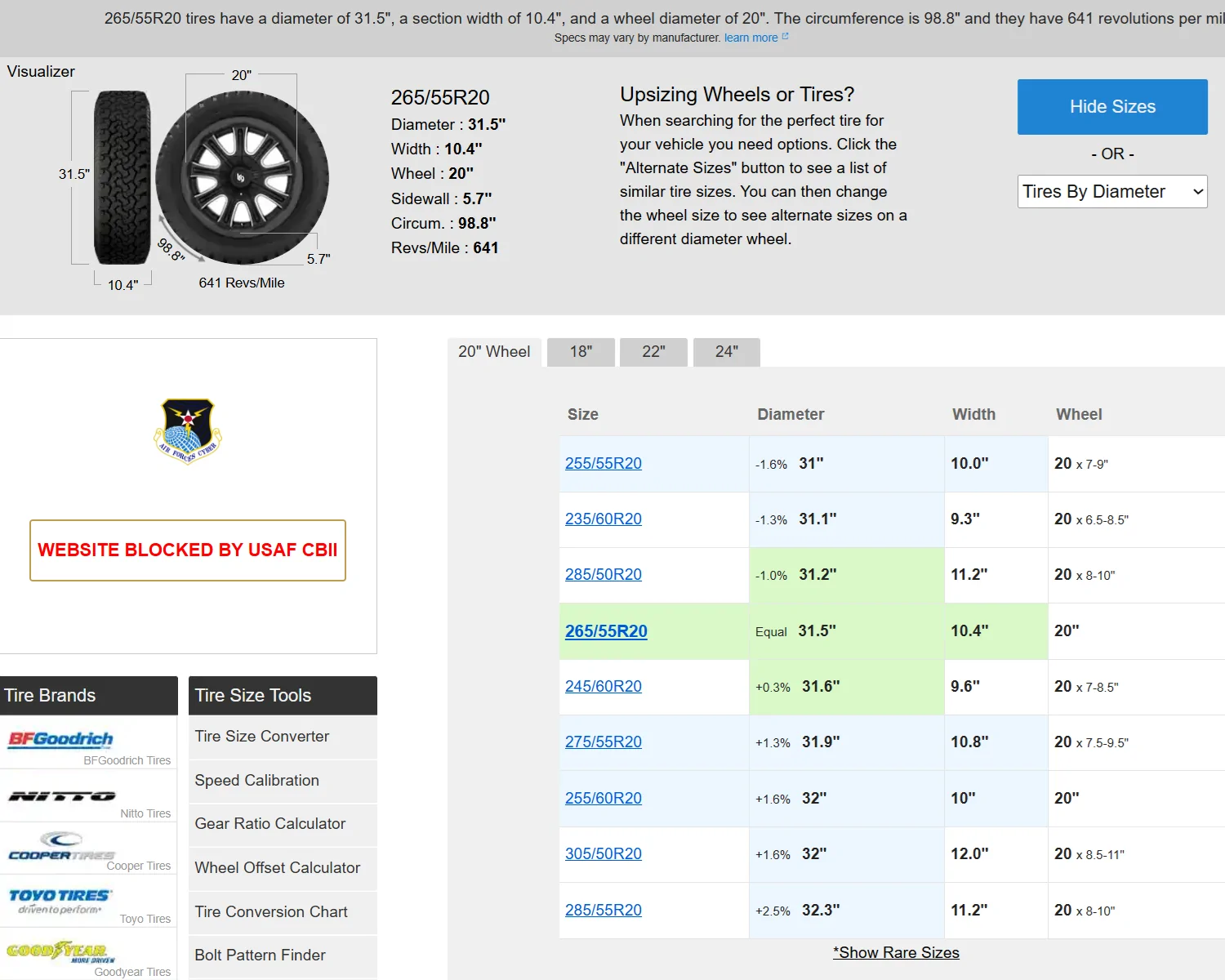

more sidewall helps more with absorbing potholes and expansion joints than more air
70 aspect ratio is where you want to be at, but 65 and 60 can work if you have a fatter tire, but you get into a speedometer issue the more out of spec you get, either +/- speed error vs actual on the display.
you can go here and do a comparsion of sizes to oem size
https://tiresize.com/comparison/
or you can use this
https://tiresize.com/chart/
and select the oem size then click the blue button for alternate size within acceptable specs that are shown in the green boxes

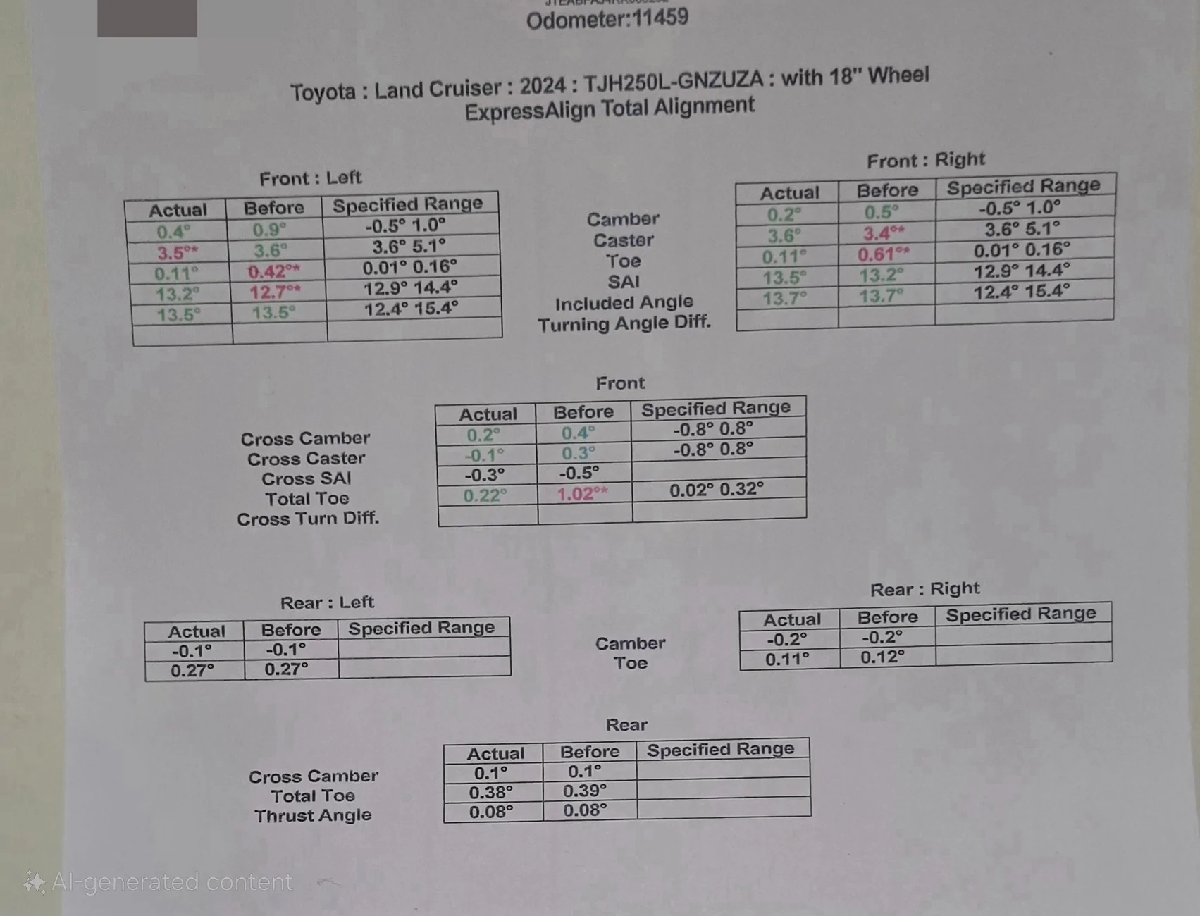

The alignment should be exactly the same as the 250 Land Cruiser. Here is my alignment sheet after raising the front up 1.5" using TRD Pro suspension parts from the 4runner.
