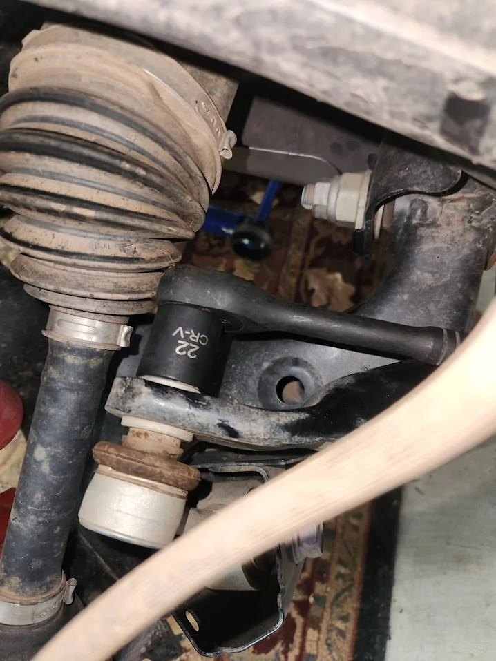

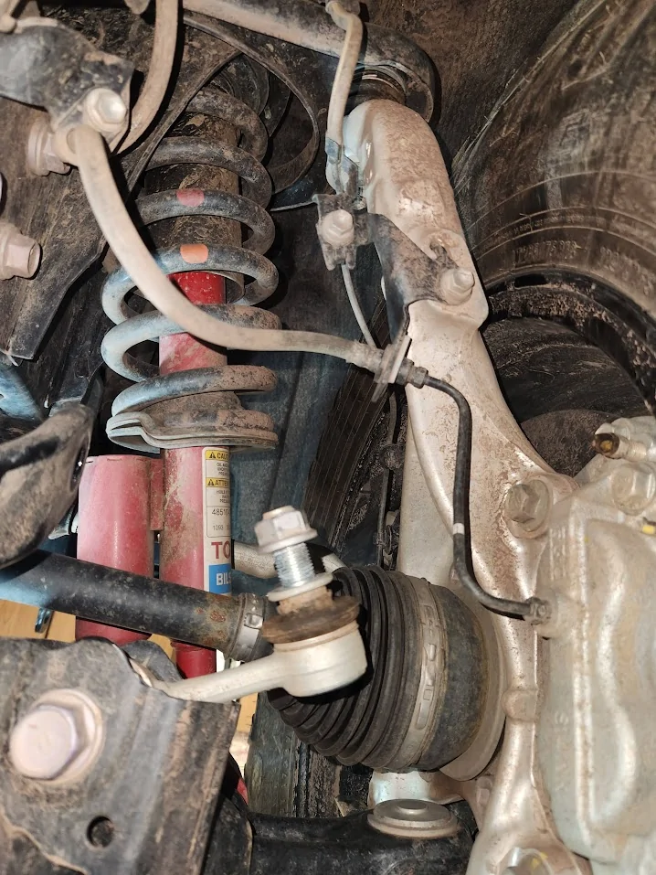

But I came here to make an observation about sway bar disconnect without the SDM.
I was able - with a LOT of effort - to disconnect the sway bar links on my TRD OR. It took a 9" piece of pipe on the end of my large craftsman 1/2" socket wrench to finally break those big bolts free. The 3/8" wrench in the photo did NOT do the trick. (Torquing them back to 159ft-# takes some effort too.)
I considered completely removing the sway bar but that would have required removing the skid plate (not too tough) and completely removing the bushing brackets that connect the sway bar to the frame. I decided to test things without removing the bar and even at full up and down articulation the disconnected sway bar does not seem to get in the way of anything (and it does not rotate easily). The links also seem to not make contact with any other parts. So I risked it and made it through a black trail without damage - at least none to these parts. Posting here in case anyone knows that I should never do that again because I just got lucky.
Reinstallation (done twice) was easy on one side - link bolt lined right up with sway bar hole - but on the other side required levering the sway bar up to get the hole to line up.
Its an extra 10 minutes or so before and after the trail (while airing down/up). I've read about this being possible but wanted to post my experience and see if anyone else has done this.
2025 2026 4runner 6th gen First Timer looking for off-road gear advice 20260417_104418
2025 2026 4runner 6th gen First Timer looking for off-road gear advice 20260417_123958
Please do not hesitate to tell me what I did was dumb and why I shouldn't do it again.
Thanks!

If you're gonna disconnect the link, remove it entirely. I'd recommend removing it from the lower control arm (it's just easier to get to, and you don't need an Allen wrench to hold it still) At the least zip tie it down - if you remove it from the bar side, zip tie it down using the hole in the lower control arm. If you remove it from the control arm side, zip tie it to the sway bar.
