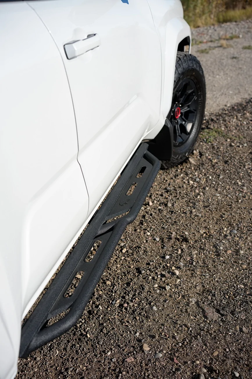

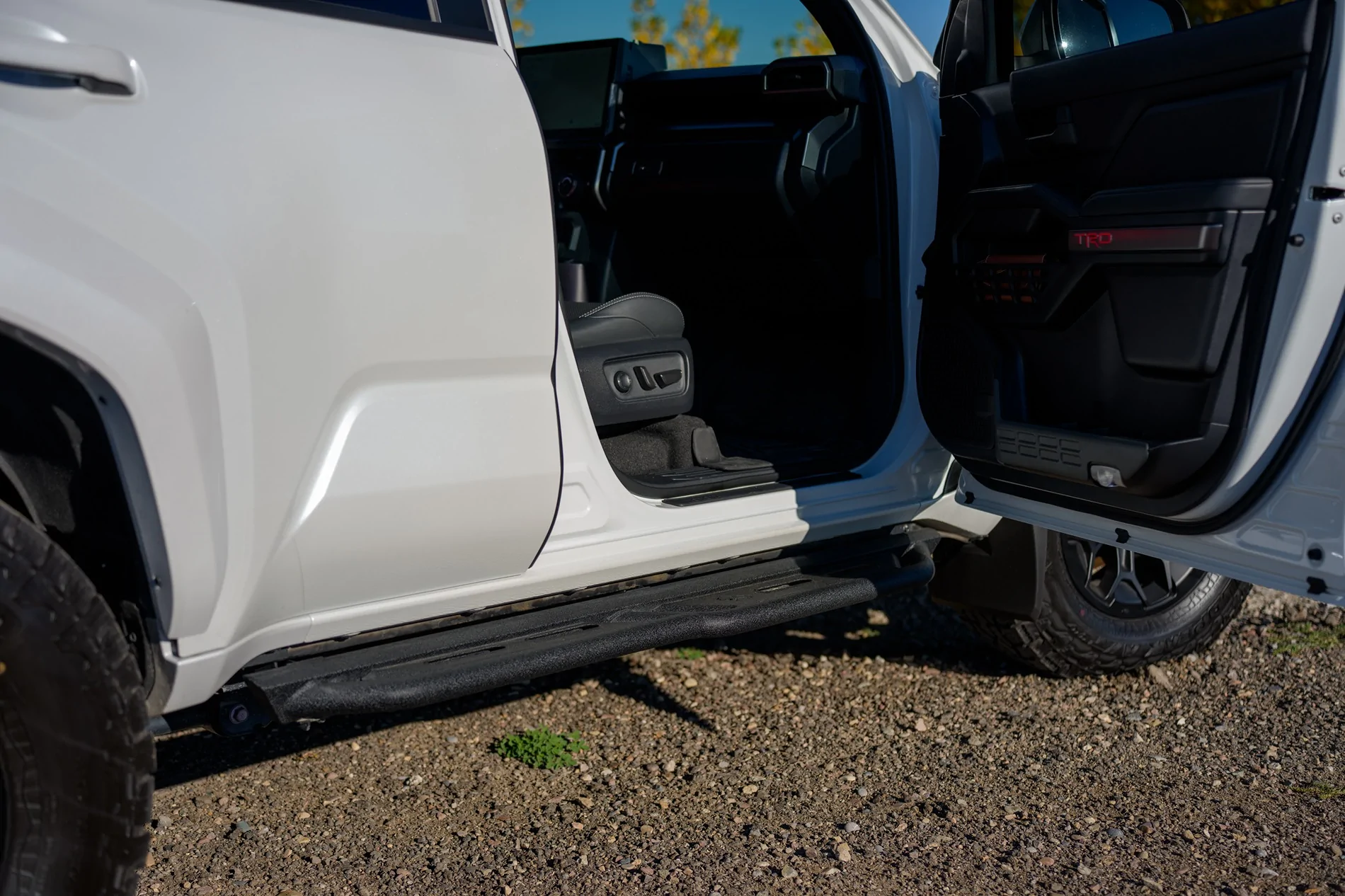

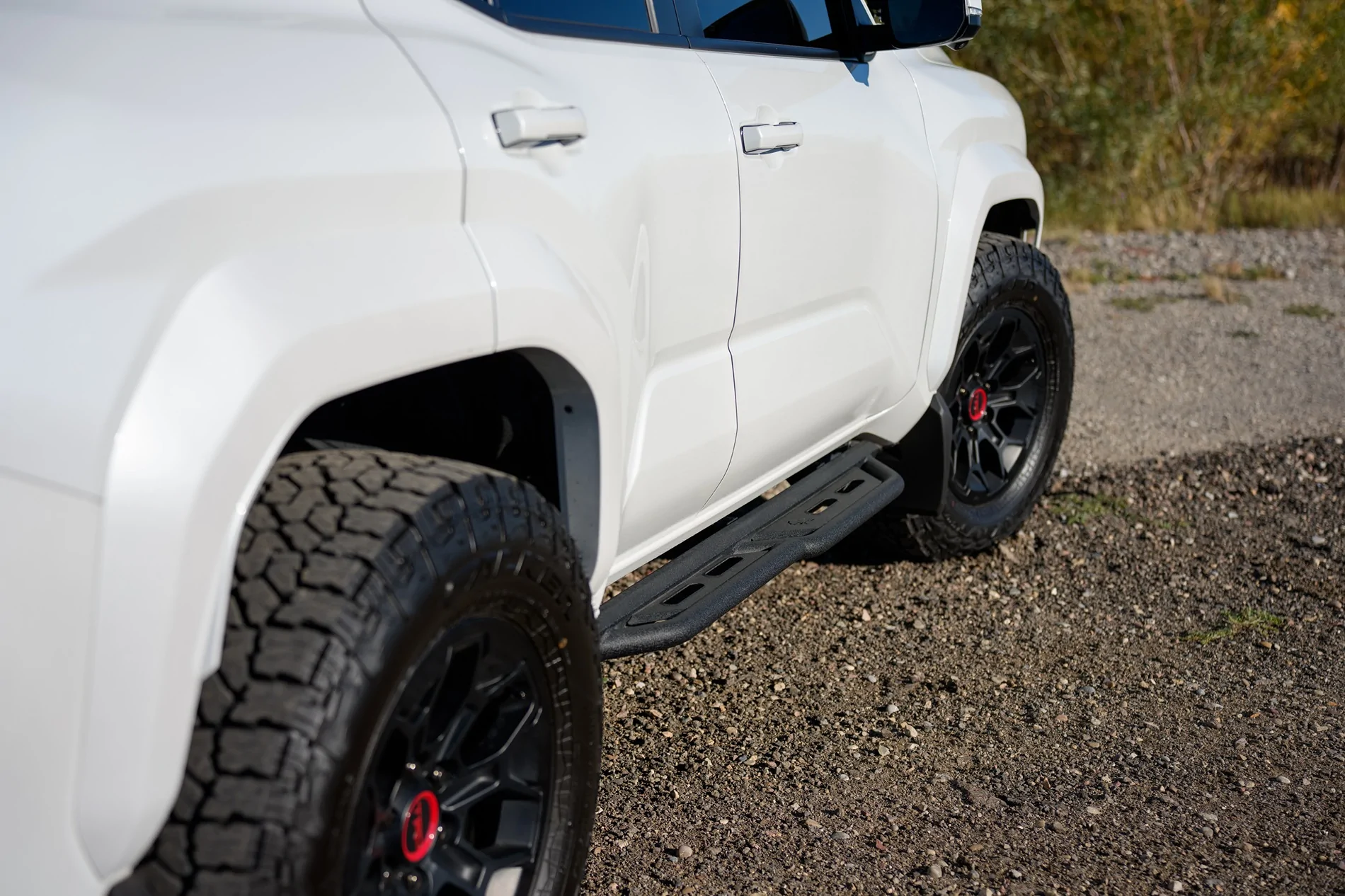

I got these Ironbison side steps that have been excellent for the wife & passengers. They look tough & grippy. Powdercoated carbon steel tubing. Not mount on frame, just the underbody but I took the car on many trails with no issue, still look brand new. For less than $300, I couldn't find anything else better.

Thanks but body mounted steps are increasing the risk of damage not decreasing it… they act as a lever multiplying any torque from impact onto those thin body sheet metal mounts and adding to the risk of thousands of dollars in auto body work from hitting a rock or a log. Too risky.

Nobody said I'm sliding across boulder fields in Moab, man. I clearly said they're steps for the wife and passengers to actually get into the rig comfortably.
They protect against road debris, gravel, and trail brush just fine for 90% of actual trail driving. If you're planning on dropping the full weight of a 5,000 lb truck onto rocks, by all means drop $1,800 on heavy frame-mounted sliders.
For under $300, these do exactly what they're built to do without adding 150 lbs of dead weight for a mall run.
