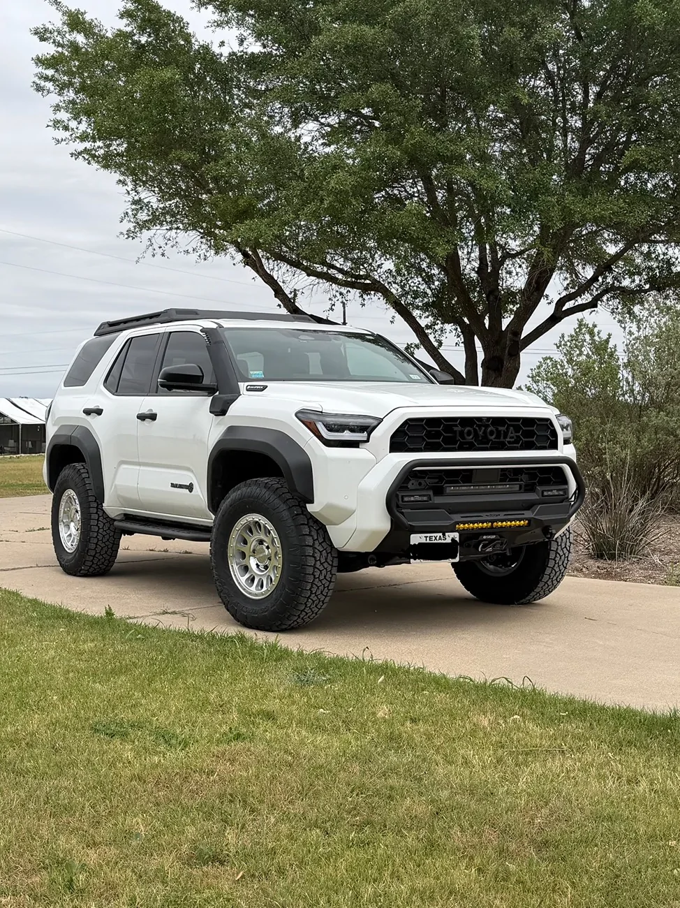

Will you post a pic, please?

Sure. I was concerned about how much weight per/corner I was adding with the load range E. Only available load range C at the time was the Falken ATW4 which is a great tire but it would have added 24 # per/corner. I have to be realistic because I’m only getting off-road 2-3 times a month so the majority of the time it’s pavement. The Method/Toyo AT3 combo adds 14 # per/corner and I haven’t had any issues off-road with the stock SL AT3 - just a little worried when I’ve aired down over rock.
2025 2026 4runner 6th gen BFG KO3 275/70/18 on Trailhunter OEM wheels IMG_0101
Your setup looks great, I have the underground color and going with similar color methods eventually. I have to balance out that 98% of my driving will be on highway with our 80 and 85 mph speed limits. But rock crawling three times a year in Colorado is definitely a concern for those sidewalls. I've watched so many professional tire reviews that my head is swimming. It's hard to balance out great highway handling, performance in rain and snow and rock crawling. I realize that three peak snowflake designation means nothing. My friends in Colorado lean towards Nokian. I've got a year to figure it out, going from Austin Texas to British Columbia and the Northwest Territory next summer, I've got some time.
