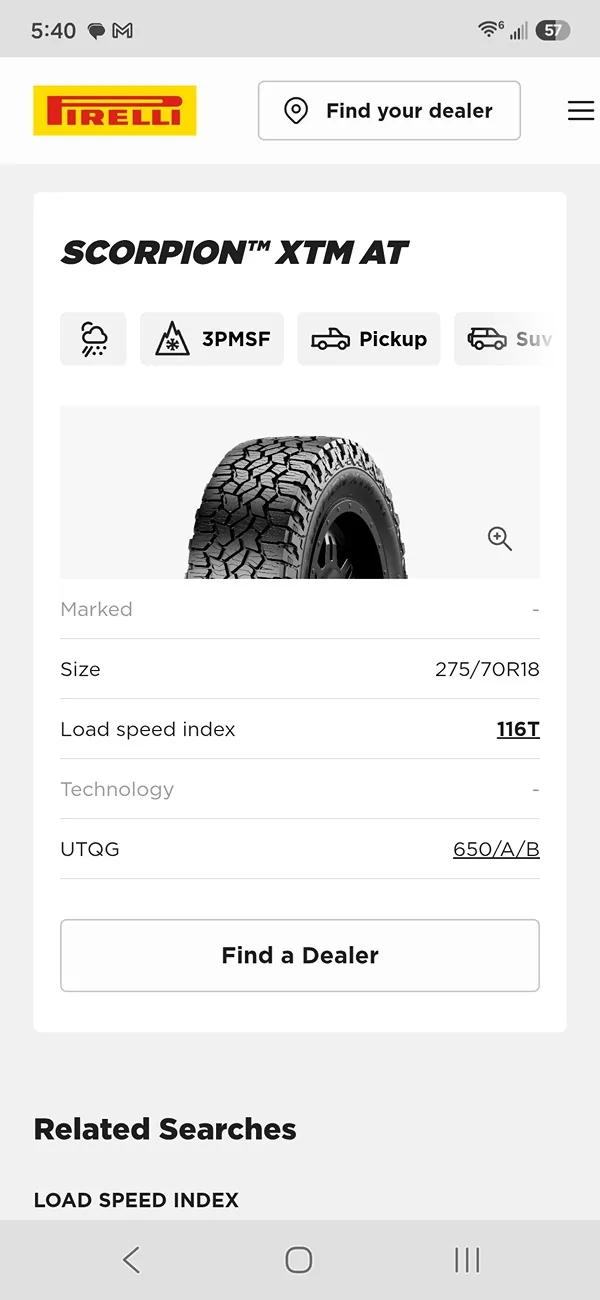

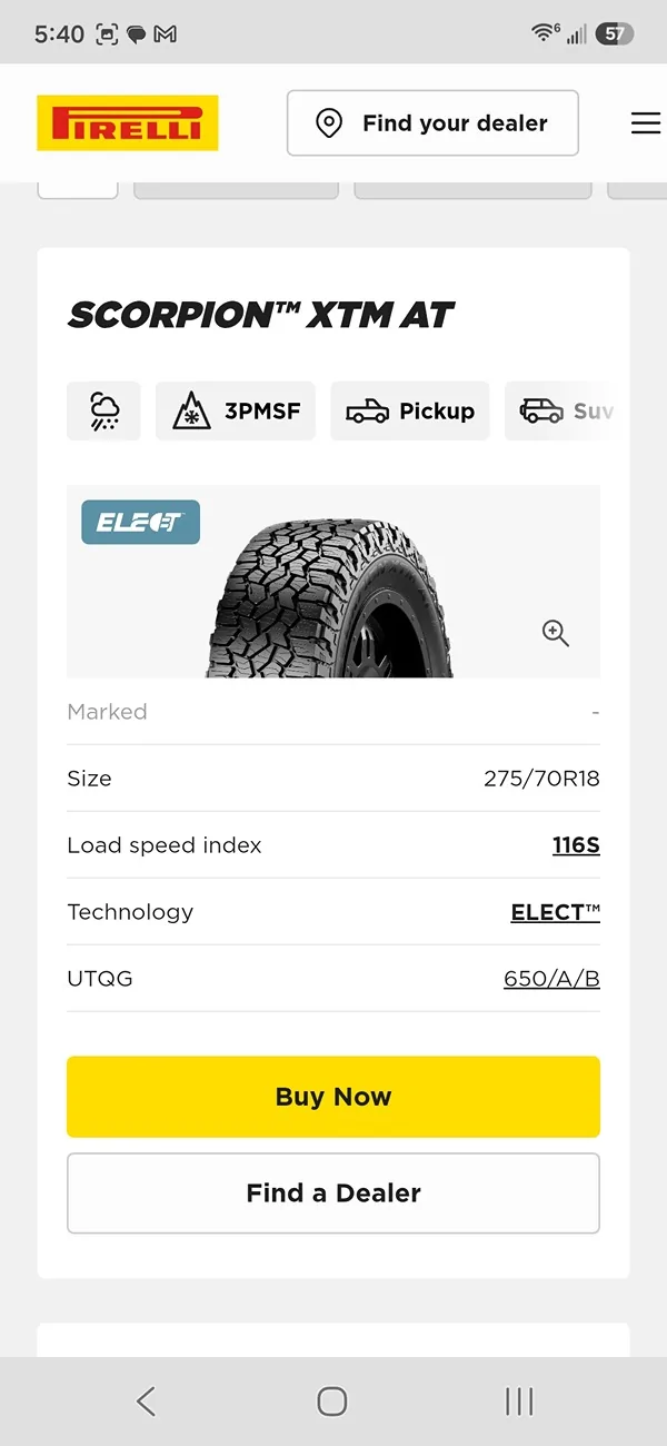

Looks like the pirelli scorpion xtm scores high. I was looking for that tire in 275/70 r18 sl load, but it is really difficult to search for. Pirelli claims it exists but I can't find it.
There is the "elect" version and the regular version and discount tire doesnt seem to know the difference between the two. The pirelli website is bad as well. People report the "elect" version, designed as a low rolling resistance at tire for heavy electric rivans is terrible in the wet and I definatly don't want to end up with those.

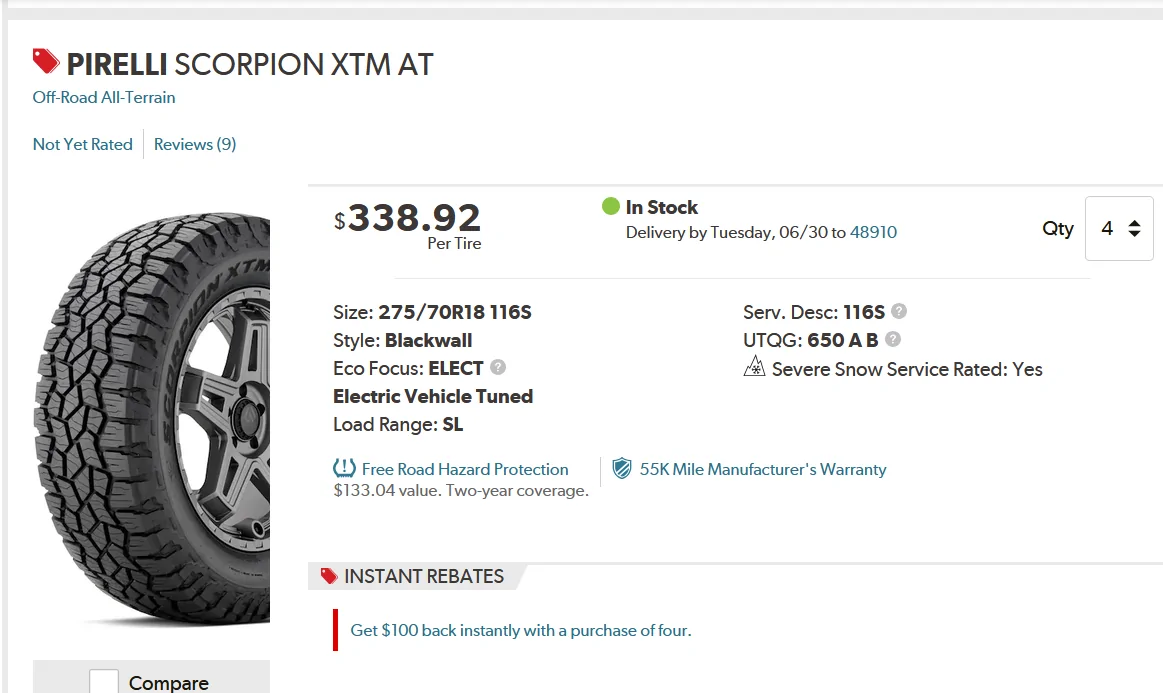

From Tire Rack's website, it looks like the "Elect" version is the SL load rated one (which is weird to me since it's for heavy electrics like Rivian/Hummer/etc.)
Yep, that is all I have found. However pirelli website catalog claims they make a 275 70 r18 116 SL "non-elect" version as well.
I ended up ordering the 275/70R18 SL version from Discount Tire and had them installed. Only then did I notice they are the "Elect" version. I went back and forth on keeping them. I decided to take the entire 30 days refund period to try them out. I live in the Seattle area so we get rain... So far, I have been quite happy with them. The "Elect" version apparently has additional noise reduction over the standard one, and I can vouch that they are nearly silent on the highway, and I have only seen about a 1 mpg reduction over the OEM Falkens.
For wet weather, they seem to stop very well and don't slip at all when I am starting off on a pretty steep hill on a wet road. I can't provide any info on hydroplaning yet since we have not had enough heavy rain to test. However, I always thought hydroplaning was pretty much dependent on the tread design and speed of travel. As far as I know, the tread is identical for the "Elect" version as the gas version in the SL load rating.
The tire is stiffer than the OEM Falkens, but I was expecting that. It apparently has a sidewall designed to handle the torque and the weight of a Rivian, so it is beefed up and likely weighs a bit more than the gas version., but I have not been able to find weight info from Pirelli. Discount tire just showed the same weight for the SL and the LT, so not much help there.
Bottom line, I have now reached the 30 day return window end and have decided to keep them. I did do an OnX 4/10 route in the eastern WA desert and they did great. Planning on taking them on the White Rim Trail in Utah in September. So far I have a bit over 1000 miles on them.
BTW, once I noticed they were the "Elect" version at Discount Tire. I told them I was looking for the gas version not the "Elect" one, and they called Pirelli to order the gas version and were told it did not exist yet in the 275/70R18 size.
My experience so far for what it is worth....

Thanks for the report on the tires! I just figure if pirelli makes versions for gas and electric, I would rather have the gas version.
I am not a tire expert, So I could be wrong about all this, but low rolling resistance, more durable tires for electric vehicles do have less grip. It is the trade off between soft and hard rubber.
If you have less grip you are more likely to hydroplane. Once the vehicle loses traction it will be more likely to float on a wet surface. I have a prius too, and anecdotal reports from many prius drivers say low rolling resistance tires are less confidence inspiring in the wet and hydroplane.
