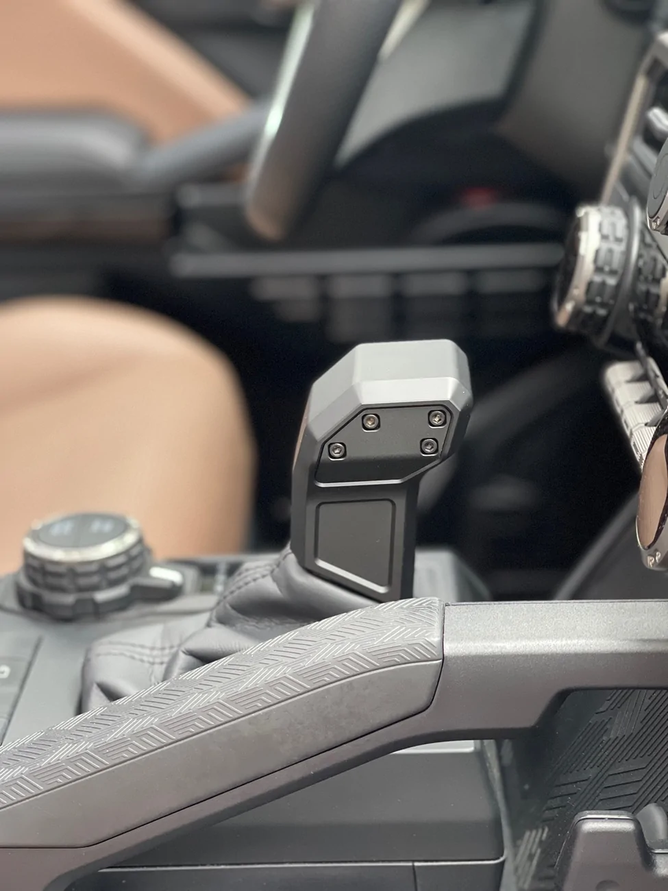

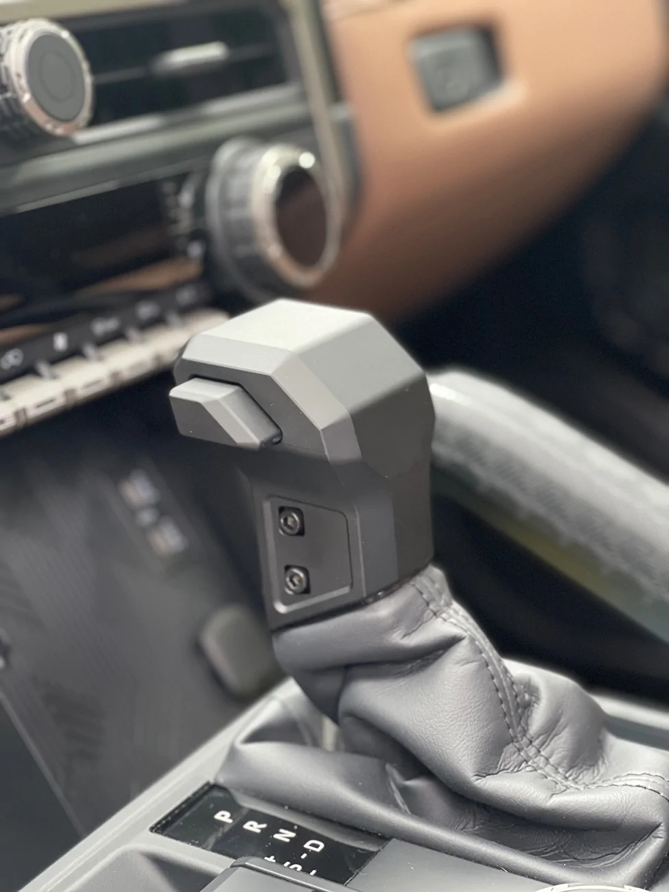

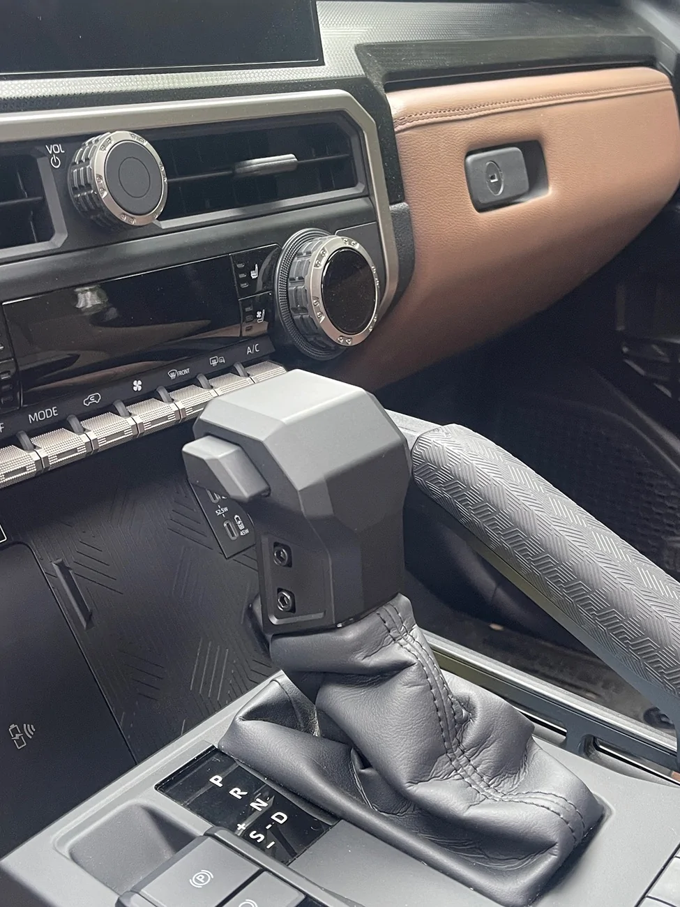

I installed the AJT billet aluminum shift knob in black oxide. It is a lot more substantial than the stock one.
To install it, you pull the leatherette boot down, pry the metal retention clip outward, and pull the knob up. The new one installs with a couple set screws. Took about 5-10 minutes. I’m really happy with it
