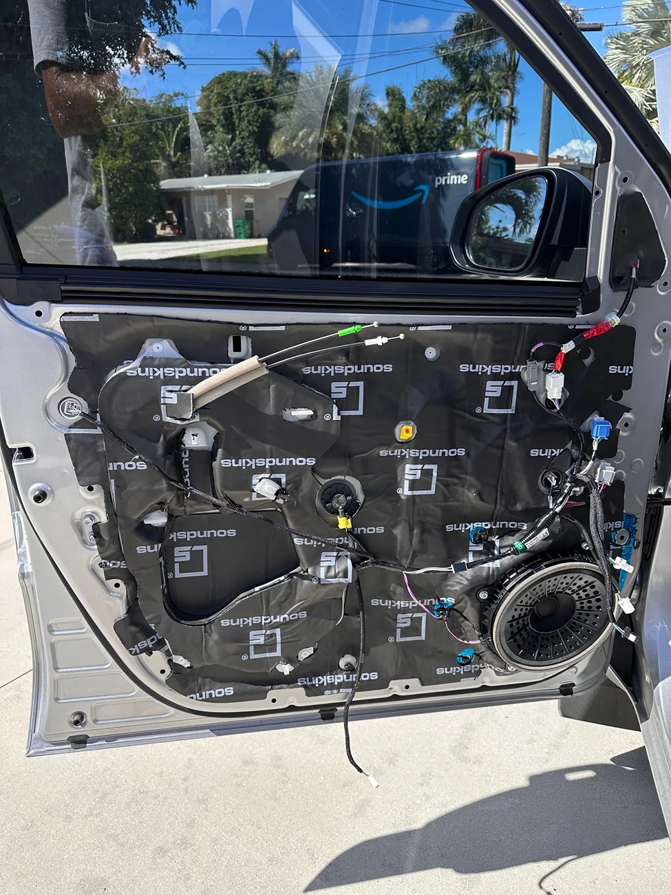

There is not enough room to install a sub under the passenger seat. Part of my current sound deadening project, I have purchased a product called Soundskinz. They have an option for custom cut pieces for the doors that cover behind your door trim. I have gotten to only the front doors. It has made a considerable difference to the stereo sound quality. I also placed some foam onto the door panel directly aft of the speaker.

Did this also help with road noise? As it’s a new car to me, are the panels just body panel levers and pop off? What was the cost of the soundskinz? Thanks!!!

Can you share how to remove the door panels, I’m nervous I’ll end up breaking off a clip.
Are you noticing any rattling anywhere else is the car now that the doors are dampened?

This youtube video shows removing the door panels as part of the installation of the Alpine speakers:
