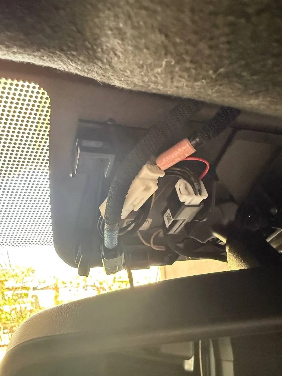

Once you've removed the shroud, the innards for the 4runner ORP are a bit different than the Tacoma ORP.
So when you get to that part of her video, refer to my 4runner photos below. Her video shows 2 cable connectors on the left side of the mirror stem in the Tacoma; with the 4Runner ORP-TT, there are 3 (one with a blue band, one white, and one pink).
PIC1:
2025 4runner 6th gen Aftermarket dashcam install using Dongar kit, on 2025 4Runner ORP with tow tech (digital mirror) 1.250(0) dongar 4rnr connections
Zooming in on the 3 connectors, you only need the pink one for the dashcam:

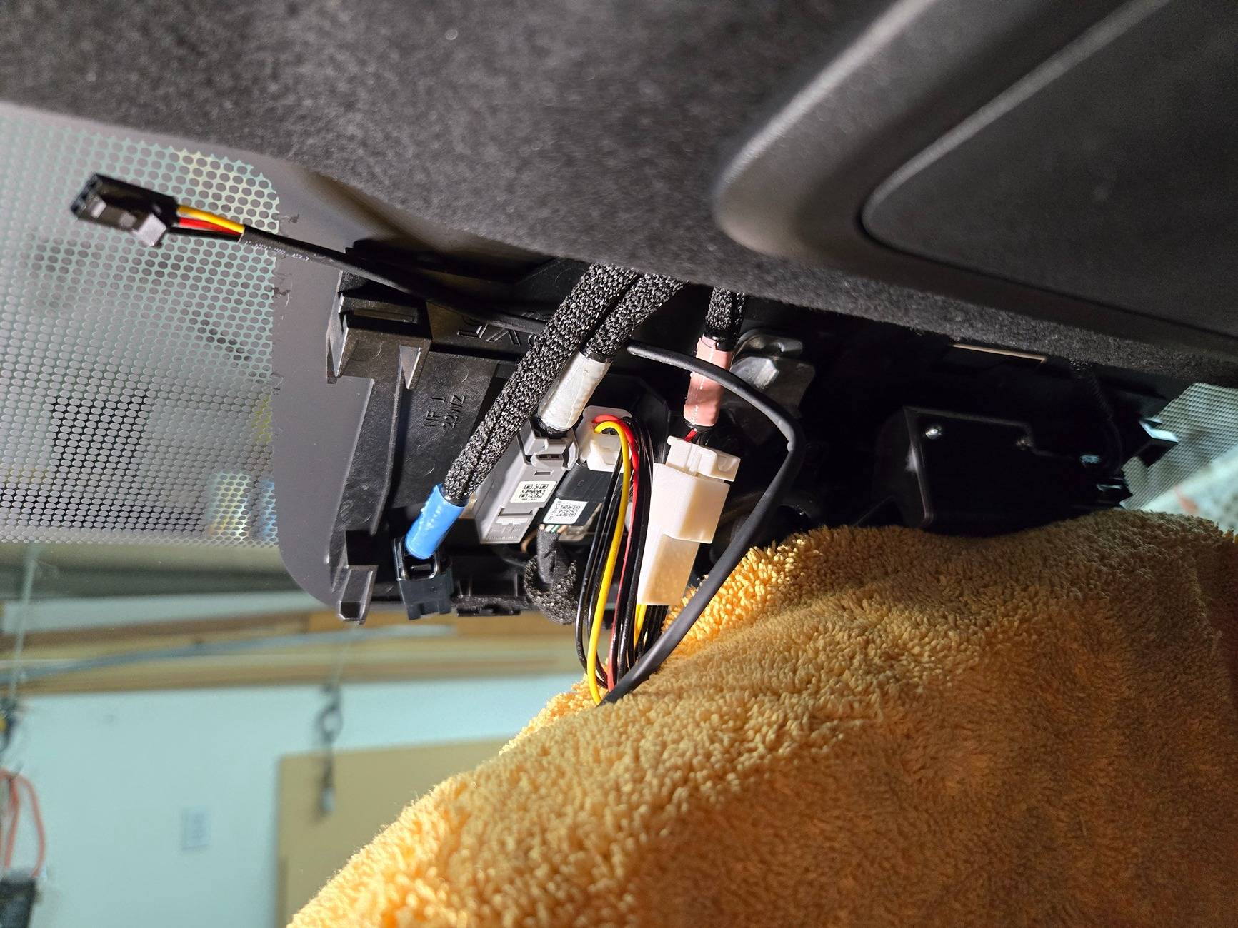

It's fairly easy to disconnect the pink cable:
PIC3:
2025 4runner 6th gen Aftermarket dashcam install using Dongar kit, on 2025 4Runner ORP with tow tech (digital mirror) 3.722 dongar 4rnr connections zoom+, pink removed

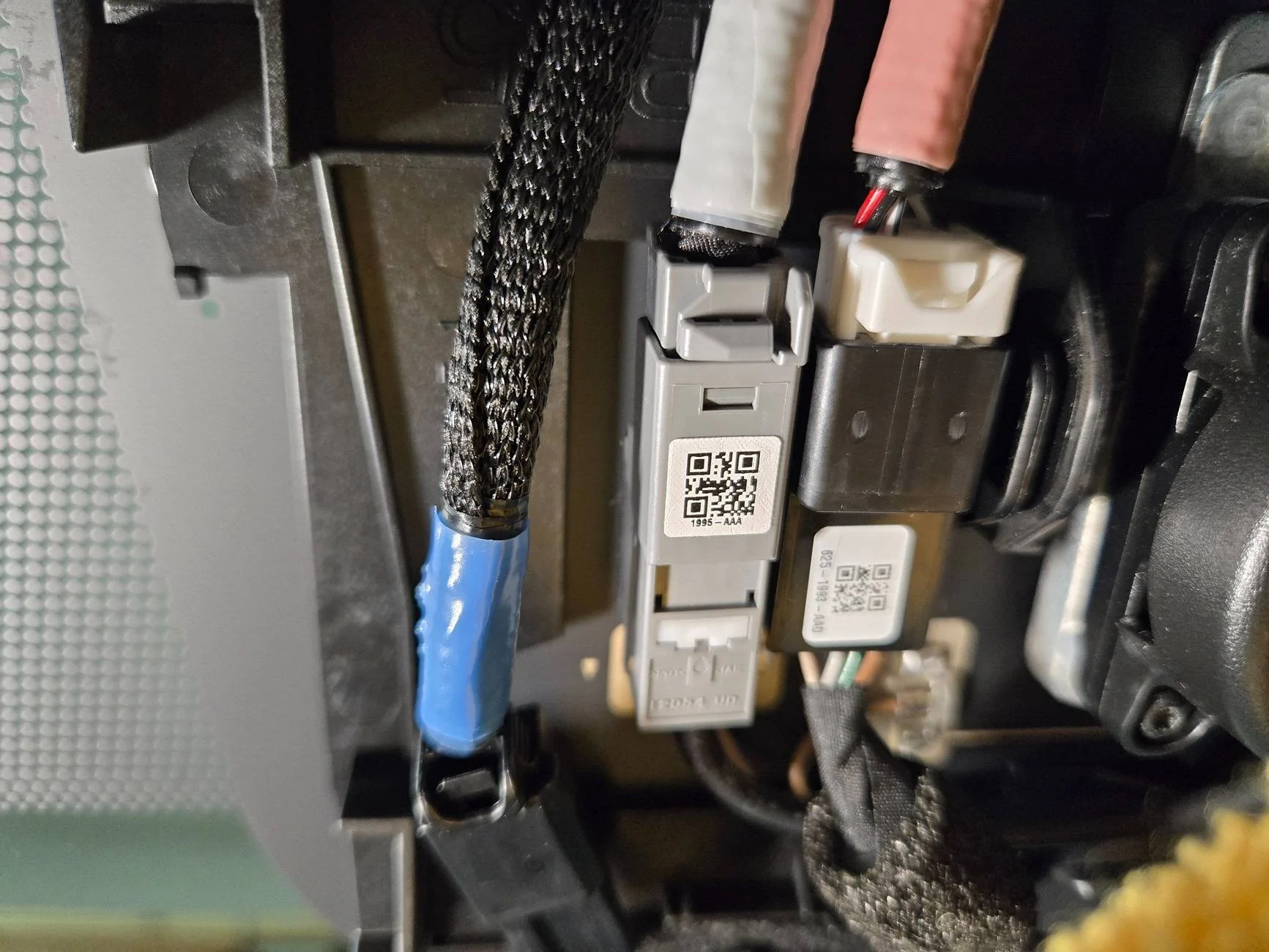

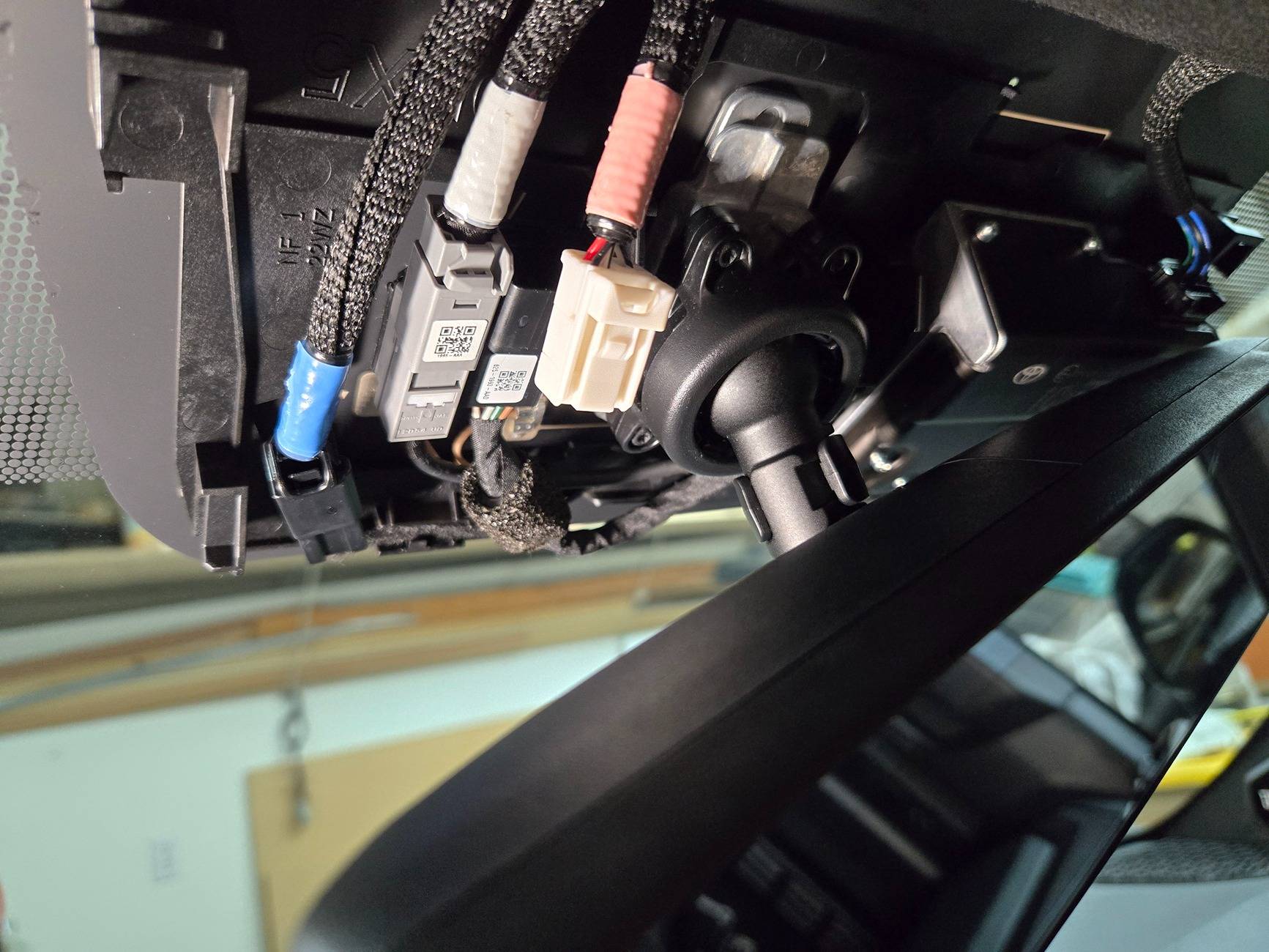

And once you've done that, you just insert the 10 pin Dongar cable in series with the original, like this:
PIC4:
2025 4runner 6th gen Aftermarket dashcam install using Dongar kit, on 2025 4Runner ORP with tow tech (digital mirror) 4.948 dongar 4rnr connections zoom+, pink removed, inserted dongar
I ran the 3 pin black cable/connector (red, yellow, black wires) in the upper left, behind the white and the blue banded cables just to get it as flush with the windshield as possible. You only need a few inches of that cable to stick out of the top of the shroud once you re-install it.

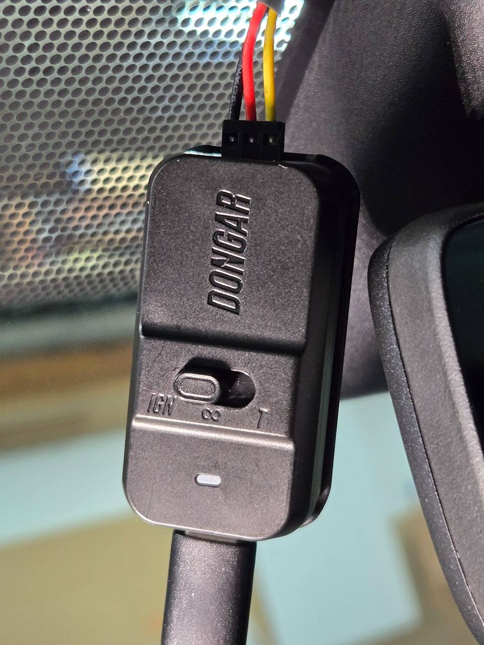

Once the shroud is back on, the Dongar dongle plugs into the 3-pin cable on one end, and you plug the USB-C power cable to your dashcam in the other end. The dongle has adhesive foam tape on the back so you can either stick it directly to the top of your windshield maybe an inch to the left of the shroud, or you can buy an electrostatic sheet to stick that to the windshield first, then stick the dongle to that.
2025 4runner 6th gen Aftermarket dashcam install using Dongar kit, on 2025 4Runner ORP with tow tech (digital mirror) 5.647 dongar switch zoom
That's all there is to getting the power for your dashcam, but installation of the dashcam from there will vary by dashcam model/size.

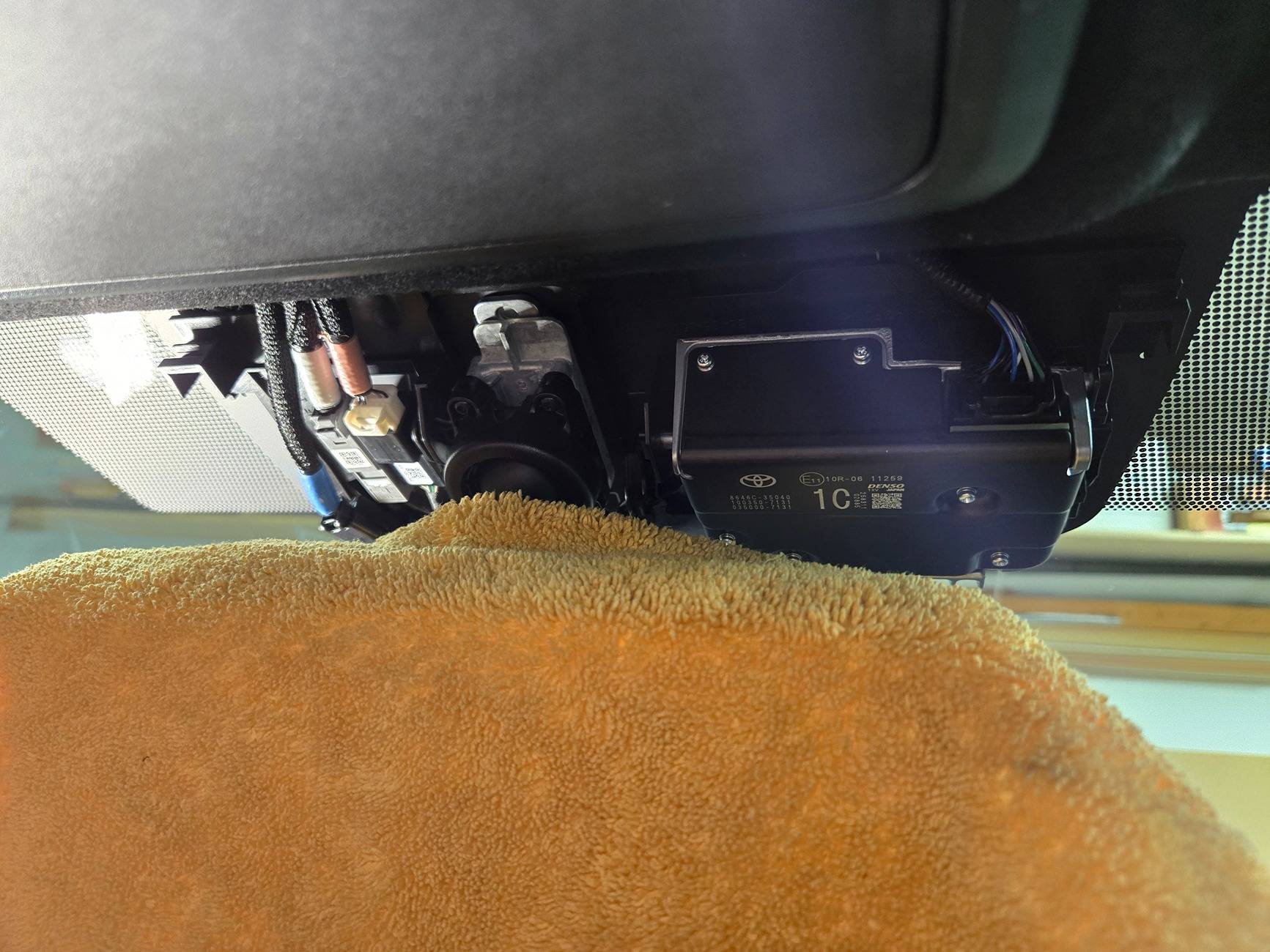

I just did the same thing this past weekend!
I don’t have the tow tech package on my ORP, but i did go through the shroud above the mirror and tapped into the same harness. Looks like the only difference with and without the tow tech is the harness with the gray tape. Which i assume is from the camera to the mirror.
Here’s a photo of mine during install when i was testing the functionality before cleaning it up.

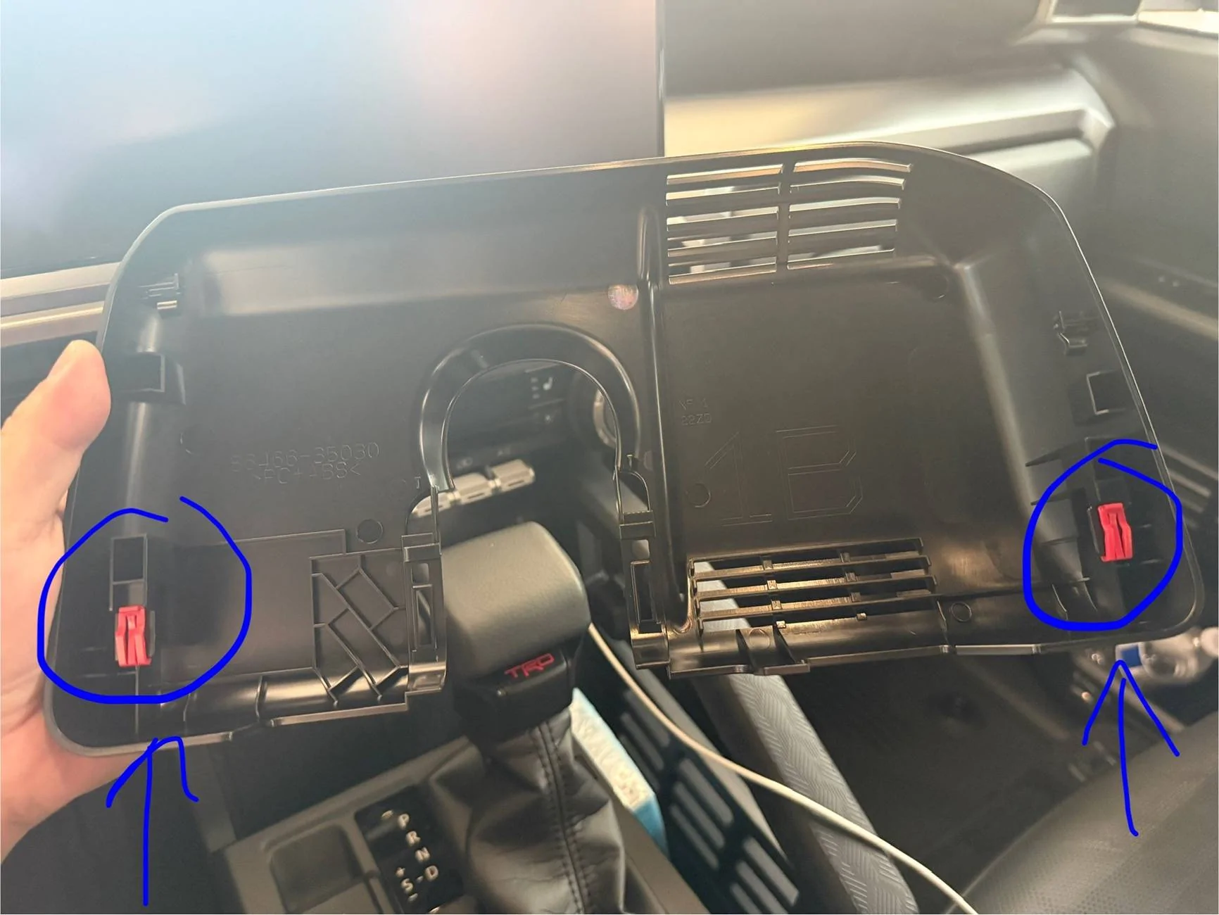

For anyone else trying to remove the shroud, it’s easier to push where i have the blue arrows shown. It does take more force than you think but it’ll just pop off. Do not get in between the shroud/windshield and try to pull it downwards and risk breaking the red clips.
