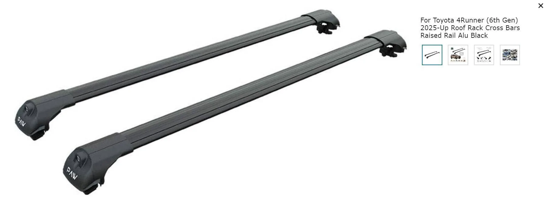

Have the factory rails on the trd orp and my wife wants crossbars. I found them on the toyota site from $330-$400. Looking at these on amazon and they say they will fit, does anyone have factory rails that can confirm they will fit?
https://www.amazon.com/gp/product/B0DH81T4DM/ref=ox_sc_saved_title_1?smid=A20IF6JGMXOW3L&psc=1
Those look like a decent set.
Looks like Thule has fitment. https://www.thule.com/en-us/roof-rack/car-roof-racks/thule-wingbar-evo-_-am711xxx
Yakima doesn’t appear to have fitment yet. I am not sure if the rails allow 5th gen products to work.
I wish there were more of them on lots, I am wondering if all trim levels have the same rails. I would assume so, but one set I was looking at mounted inside the rail, I believe they are for a 24 not a 25.

Our 2025 we just picked up last week has the factory cross bars. They are gloss black and rap around to the outside side, and are very nice and look way better quality than those from Amazon. I would say if you don’t mind paying the Toyota price, go for it!

I'm a bit disappointed with the 2025 factory rails. They look similar to the 5th gen, but if you look closer Toyota has removed the inner channel and this limits some of the potential aftermarket options.
For lower profile cross bars on my 5th gen, I have the LFD Off-road cross bars attached to the factory rack. Looks great and keeps my cargo box (when used) lower to the roof.
The 2025 factory cross bars clamp on top of the rack bars adding unnecessary vertical height. IMO they also look a bit goofy, but clearly they get the job done if that's all that matters.
