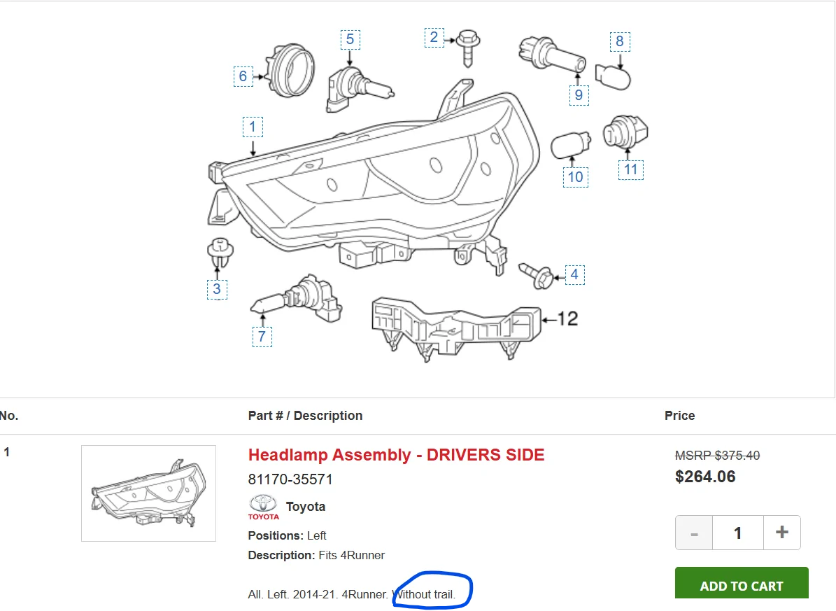

Can I just purchase OEM LED Headlight assemblies off eBay and swap them in my 5th gen 2015 SR5 and they'll work? Or do you have to get specific ones, have to program them at the dealer, etc? If it's just a different wiring harness that's needed, does anyone know where I can purchase that and if there's any swap guides? Couldn't find any on YouTube. Thanks in advance!

all factory assemblies for 2015 are the same except Trail
OEM comes with all the bulbs pre-installed
plug and play, nothing to do except install, plug them in, and aim them
