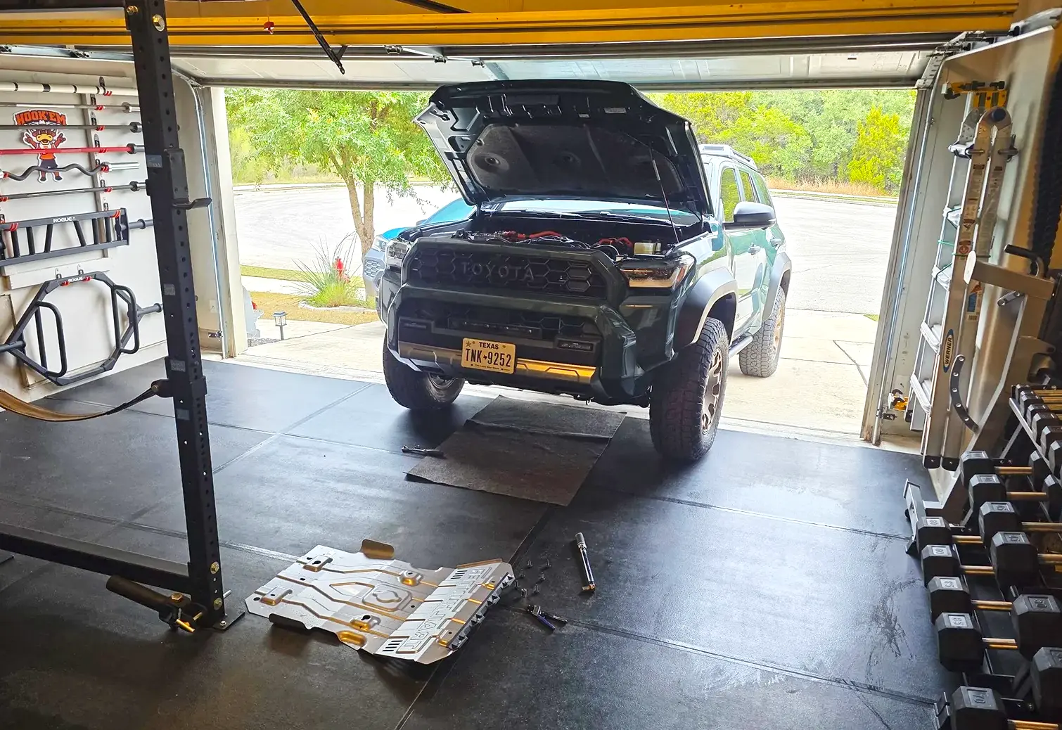

Just need to get the skid plate back on. Flushed a quart through after initial drain. Might be my imagination, but it looked like some particulates draining out with the initial drop.
Kudos to Toyota, not as easy as my top mount filter on my Subaru, but still in a very convenient spot. I didn't change it this time, just noticing.
Thanks for the info from this sub. Now to balance the skid plate on my head again and get it back in place.

Did you replace the filter? When I did my 500 mi drain/flush/fill I left the filter in based on the motor oil geek’s recommendation from YouTube. I measured just over 5.5 qts drained, so put that amount back in.
I find the dipstick incredibly difficult to read given the thinness of 0W20 and the freshness of the oil, but I feel like it looks right… was just curious what you found!

Didn't replace the filter. I was just under 6 quarts to a perfect spot. The interwebs says it's 5.6 if you are changing the filter and 5.9 if you aren't.
I also found 36Nm a little heavy for the skid plate bolts.
