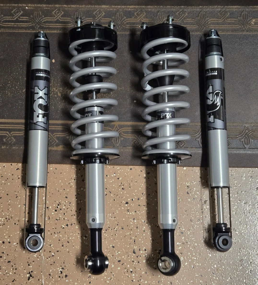

My solution arrived today. Fox 2.0 install next week. Even if the OEM ride was good, I would have still installed these for a 2" front lift. Also, Peak Suspension 1" rear spring spacer is on the way.

Our goals were a 2" front lift, 1" rear lift for our mild off-roading; and to eliminate harsh jittery road seams.
On Monday, our dealer installed our Fox 2.0 fronts (2" lift) & rears with Peak Suspension 1" rear spring spacer followed by an alignment. Since then, I have driven 240+ miles including several roads with known harsh seams, cracks, and bridge seams. The jarring harshness is pretty much gone. Some of those are now a dull cushioned thud. If you didn't hear that thud, you wouldn't notice the bump much at all.
Tires are E-Rated Toyo OC A/T3 LT275/70R18 which are 14 pounds heavier than the OEM Falken AT3WA 265/70R18. The extra weight contributes a bit to the clunkiness which I don't mind because I installed E-Rated A/T tires to reduce chances of rock damage.
It does still ride like a body-on-frame truck rather than an SUV ride.
It's still early, but so far our suspension upgrades are a big improvement without breaking the bank on extreme off-road suspension parts that we do not need.
