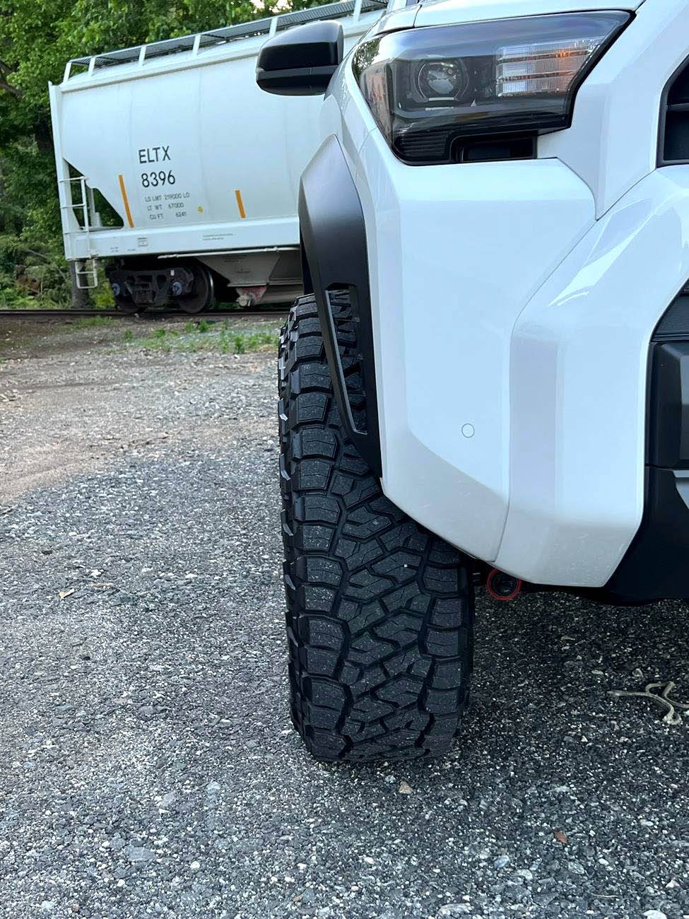

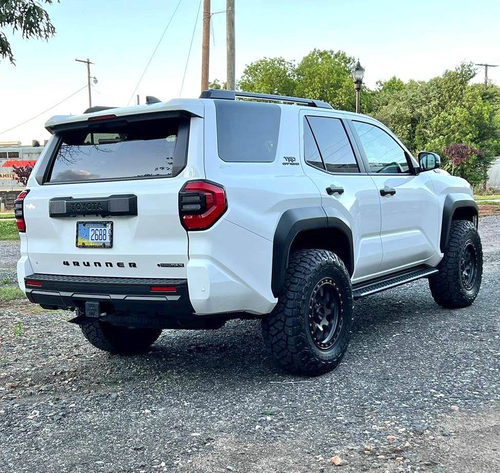

Westcott Lift 2/1
KMC Riot 18x9
Toyo Open Country R/T 295/70/18
Black Front Emblem
No rubbing issues so far
Man that looks good, but it's absolutely going to smash the fender trim if you ever fully articilate the suspension. What offset are you running?

Stock 18” with 8” width rims have 45mm offset….Dang thats more than yours….sure is the set up I was trying to figure out, but I have a 3.5” lift in the front and a 1” rear…..Now Iam getting confused😵💫😵💫😵💫😵💫😵💫😵💫

Your rims in the pics seem to almost come out perpendicular to the fenders at the start .Where stock rims are inside quite a bit? Thats why I thought I need spacers for my wheels….You sure you do not have spacers for those wheels to increase the offset?

No spacers, just offset and 1 inch wider. Here is a comparison from stock to ours. I just used a generic tire size for reference.

Now this explains an awful lot! So it seems I can keep my stock wheels and use a 1” spacer to clear obstructions… You have 33” Iam wishing for 34”Thanks for the diagram!
